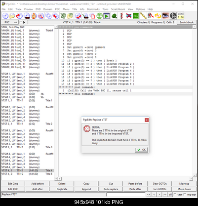

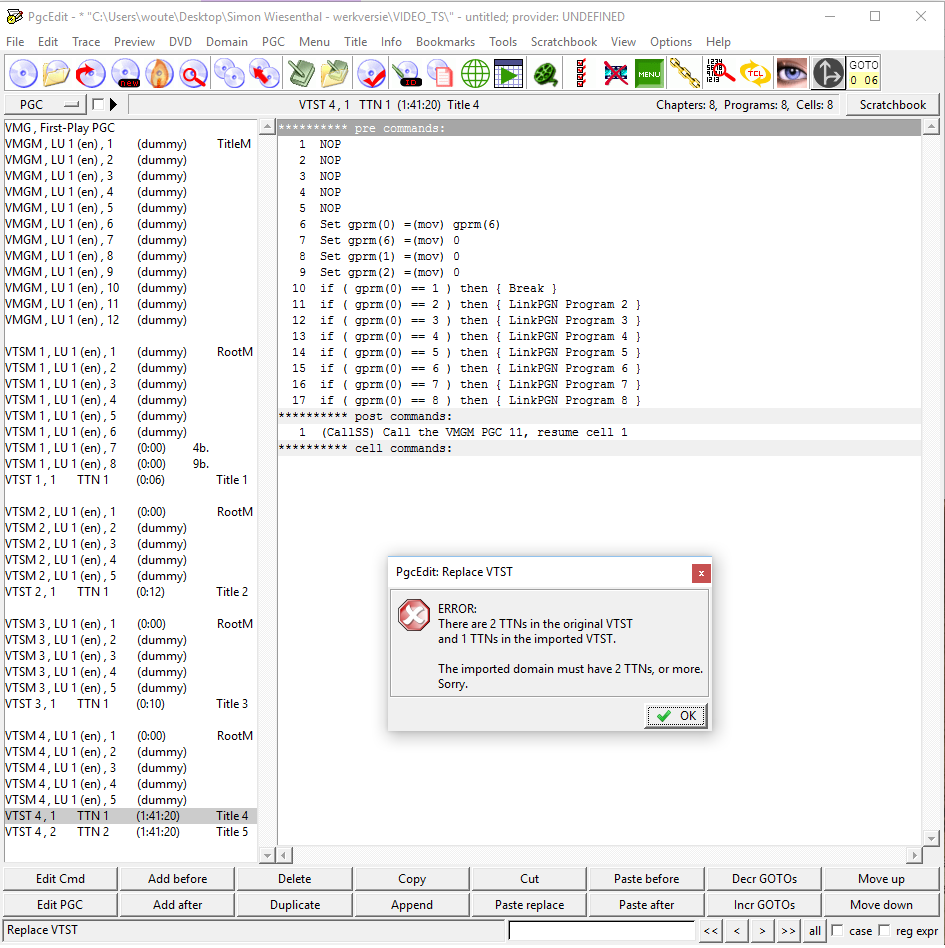

    Thank you manono, for your quick reply and help. Now I have followed your advice, however PGCedit gives one error message due to the fact that there are two TTNs in the original DVD and only one in the edited version. I'm not really sure what this al means, therefore I added a screenshot.
    What to do next? Edit: Never mind, I already found the solution
    Edit 2: Ok, maybe I have not solved the problem. I just deleted the last TTN, replaced the first one and the DVD can be played. However when I want to navigate through the navigation menu to one specific point in the movie, the VLC player crashed. Does this have to do with deleting the last TTN, is there a way to solve it?
    Edit 3: The current situation is, the movie is edited as it should be, however the navigation menu to jump to specific points in time does not work, but results in crashing of VLC. So the navigation menu needs to be fixed, is there any way to do this? The probleems seems not having anything to do with deleting the last TTN, because when I tested it directly after deleting and all worked fine. However after inserting the remuxed VOBs, or replacing the VTS files in PGCedit, the navigation menu is broken.

  6. Well, when I wrote my previous response I was thinking it might be that, but it's rare enough that I didn't mention it. That's a problem with PGCEdit - that the replace doesn't work when there are two titles in the same domain. Go to Plan B.
    Open the original DVD in VobBlanker. Highlight the movie in the top screen so that it appears in the bottom screen. You'll see two titles, just as in PGCEdit. But one will have size and the other won't. One will be many MB and the other nothing or almost nothing. Highlight the one with size and hit 'Replace' over on the right side. Scroll to the correct IFO for your fixed version and take it from there. I prefer to use PGCEdit for this, when possible, (and I do it a lot) because you don't have to process the entire DVD. You can just move VOBs. So, VobBlanker is a little bit slower but it works.
    You remade the fixed DVD with cells/chapters by now, right? And if you've messed up the original DVD with all that fooling around, PGCEdit saves the original IFOs so go File->Backups->Restore Backup. While working in VobBlanker you might want to 'Blank' (remove) any unwanted warnings, logos, trailers, and any other useless garbage in the DVD.
    Sorry for the hiccup. Good luck.

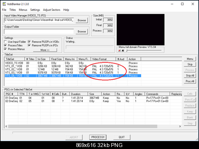

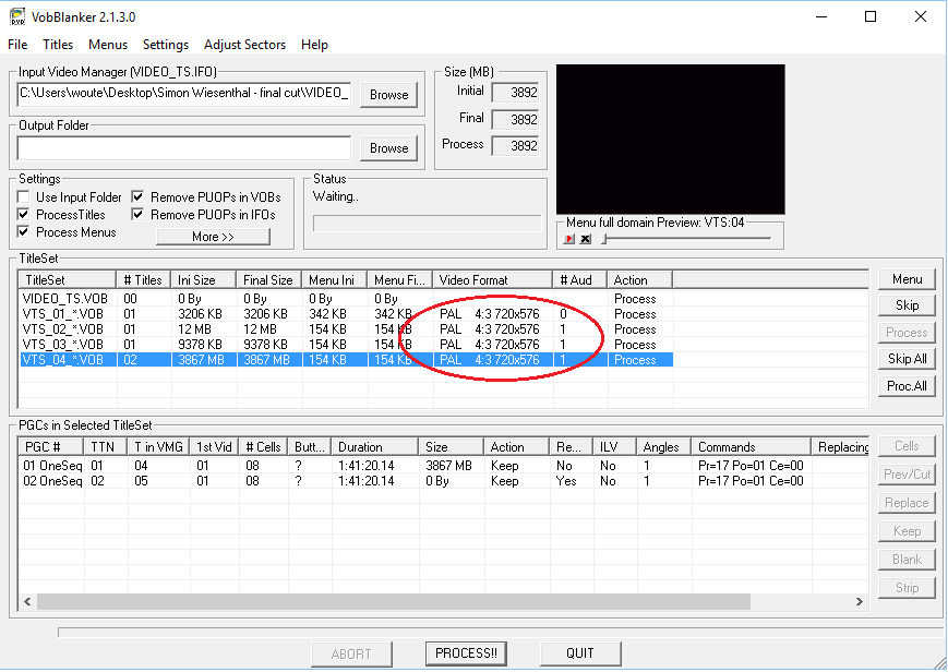

    No worries about the hiccup, Im very happy with your help so far. However the story is not finished, due to the fact that I now have a problem with the format of the remuxed part. The original movie is played in 16:9 format, however after remuxing the video is in 4:3 format. I tried to modify the settings in Muxman, but it would not accept it. Therefore the question now is, is there any way to change the 4:3 viewing format to 16:9 view format. The pixel ratio can just remain the samen, I just want to reauthord the DVD as it was originally. For clarification I added two screenshots, one of the video format as it is original, and one after demuxing, editing, remuxing and replacing through Vobblanker.

  8. Highlight and right-click in the upper window the one you want to change. Click on 'Video Attrib'. In the new box you can change it to 16:9. You'll probably also want to check 'Automatic Letterboxed' which defines how it'll be played on old squarish televisions.
