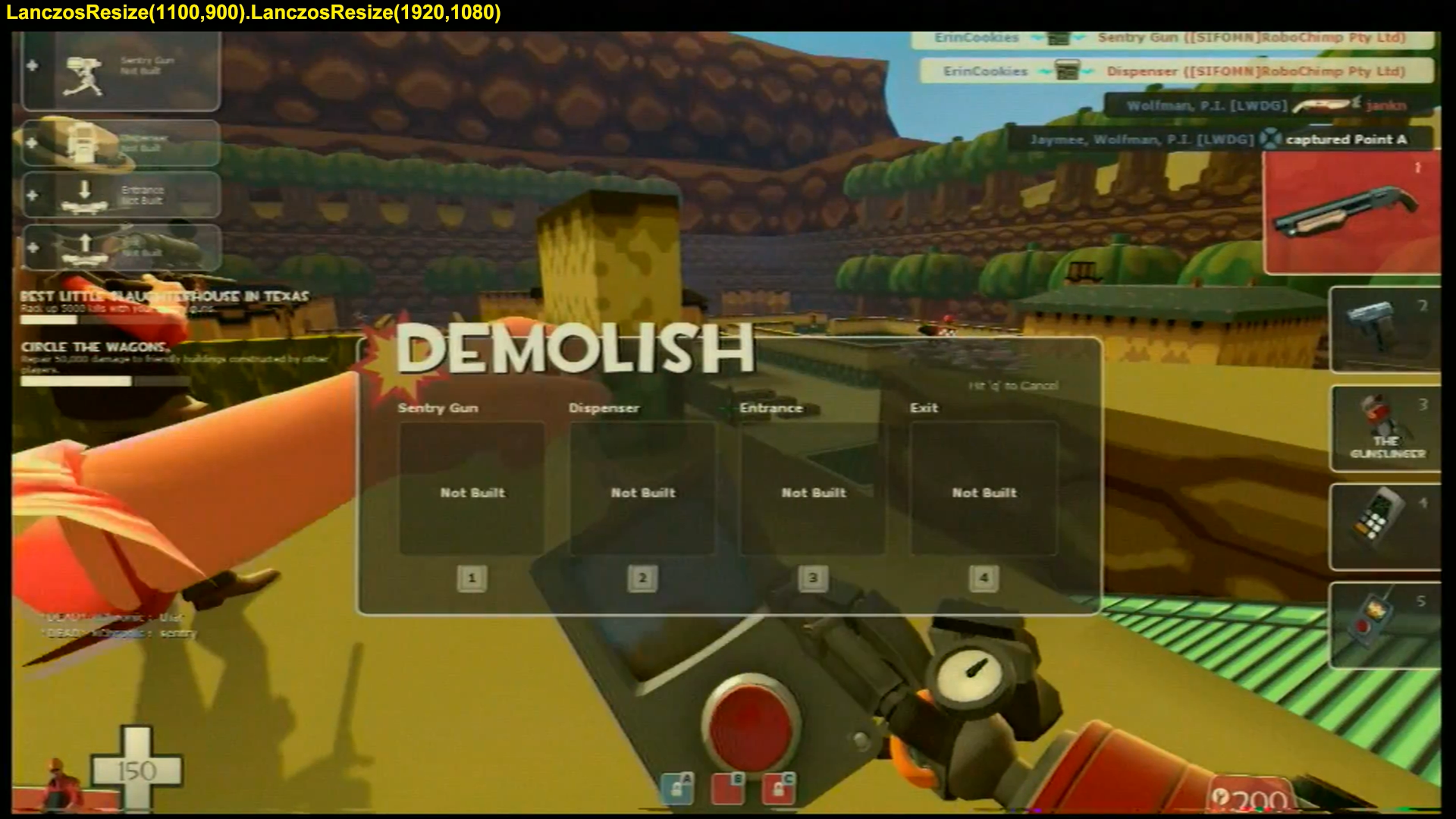

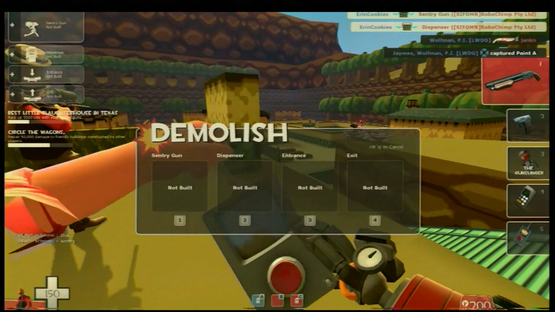

    I found this by accident:
    YouTube deinterlaced the sample from 1080i60 to 1080p30 with its horrible interpolation, but even their processed garbage demonstrates vertical resolution above 850 at least. To me the resolved resolution looks to be in the vicinity of 1100x900, which is better than I expected. I'm specifically looking at the "5000" in "Rack up 5000 kills" to judge.
