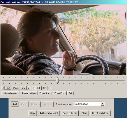

 As far as editing goes, you'd create a script for encoding, or MeGUI does it for you, then you open that script with MeGUI's AVS Cutter to edit. That part wouldn't be much different to editing with Avidemux. Zone start and end points, navigation buttons, a preview, except without any need to worry about keyframes.
 [Attachment 36348 - Click to enlarge]
 MeGUI has a bit more of a learning curve, but there's a lot of benefits to Avisynth. It depends how much time you want to spend on it though. Once you know your way around MeGUI it's not as daunting as it might sound. It has a GUI with a preview for applying cropping, resizing and de-interlacing etc, much like you'd do it using Handbrake. You don't need to understand anything about creating scripts, MeGUI will do it for you, but at the same time you can experiment and get to know Avisynth along the way, if you want to.
