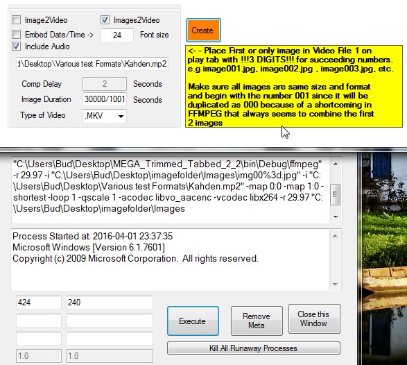

    FWIW... FFMPEG used to combine the first 2 images into some composite that would shorten your video and unsync it with any audio. I used to just start the images at images-001 and copy 001 to images-000 as a workaround. Haven't used it for this with the later levels but think it still does the same thing.
Name:	ScreenHunter_190 Apr. 01 23.40.jpg
  26. @budman1 - I don't think that that bug exists anymore, or at least it's not present in ffmpeg builds over the last few years
    The more common problem is when exporting image sequences with ffmpeg, they start with "one" instead of frame "zero" (e.g. img001.png instead of img000.png). Most software such as NLE's etc... "expect" to start at frame "zero". The "fix" for that is -start_number 0 .
