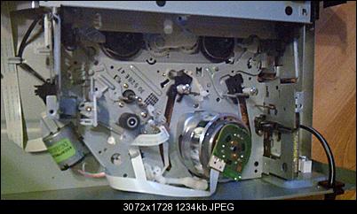

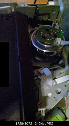

    Mar 2016
    If I do decide to clean the VCR with 99% Alcohol and the required swabs where exactly do I need to clean? I have done some research on these terms you are using and I am lost as to what these look like (I am a novice with VCR terms). I have included a photo of the VCR. It is a Sansui Model No. VCR4512. Click image for larger version

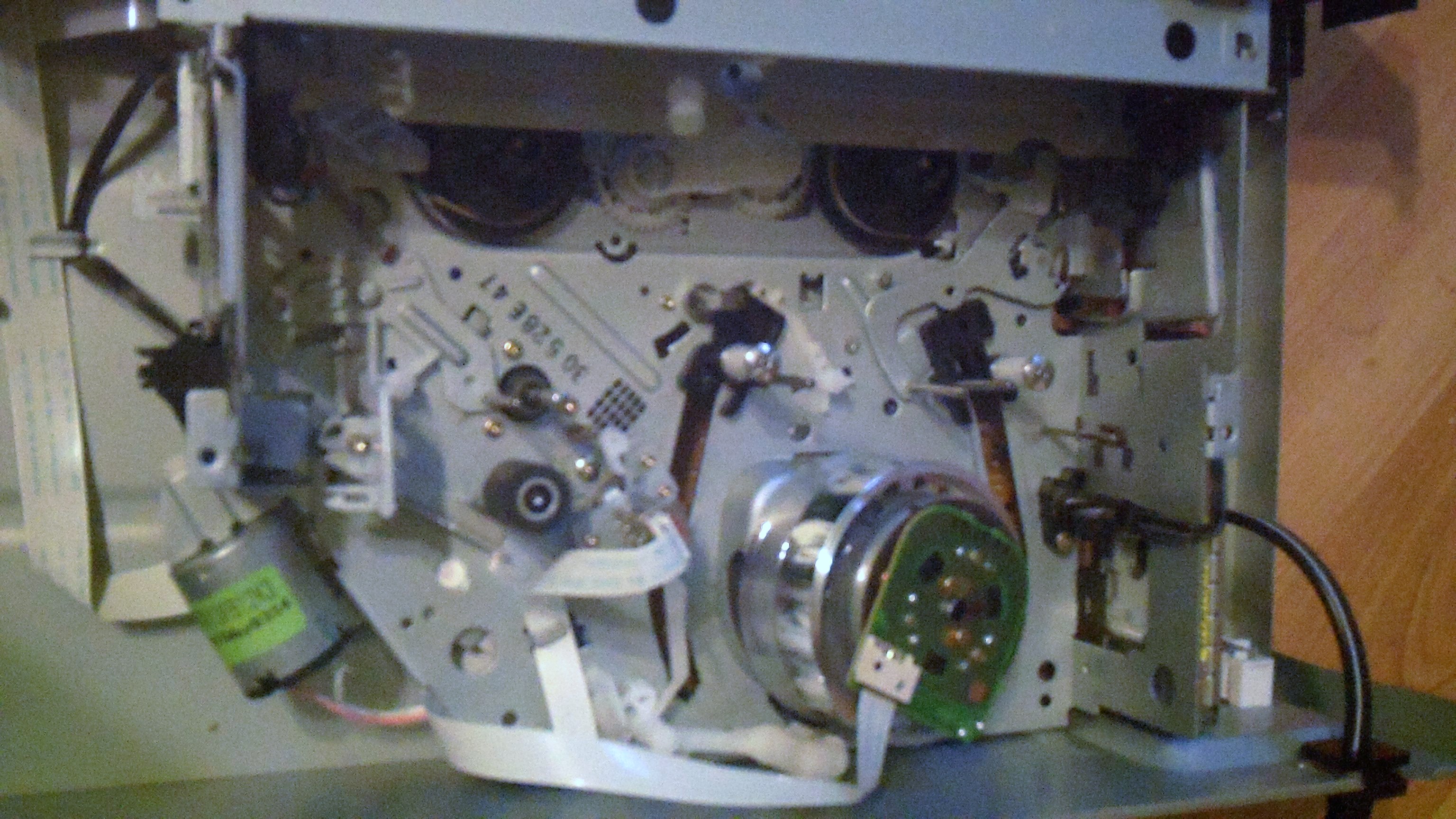

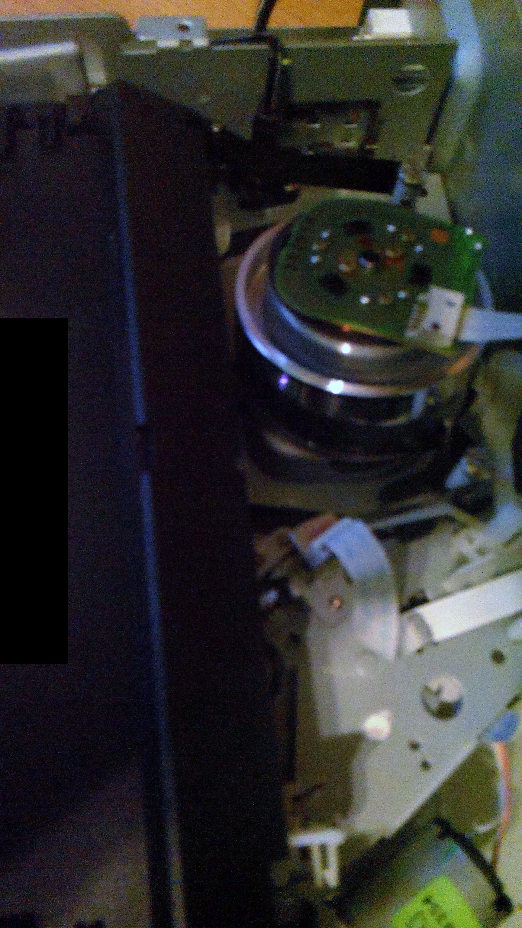

    If there is a misalignment in the VCR, then I have another photo that might be helpful to explain this problem. Click image for larger version
    I hope that these images will help better explain my problem.

    Wow that is a "Plain Jane" model huh?
    Clean the face of the drum, all of those metal spindles, the rubber and plastic roller(s), and the "head" with the ribbon cable attached to it.
    That's it. Not brain surgery.
    "Alignment" is NOT something you are going to fix/adjust on your own.

    Aug 2010
    San Francisco, California
    Insert a tape with the cover off and press PLAY. (If it doesn't work normally you may need to lower the room lights.) Take a picture showing how the tape is threaded through the machine. Then eject the tape, turn off the power, unplug the deck from the wall, and clean everything that the tape touched. You can use swabs everywhere EXCEPT the rotating drum.
