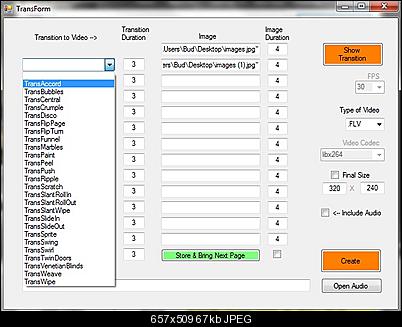

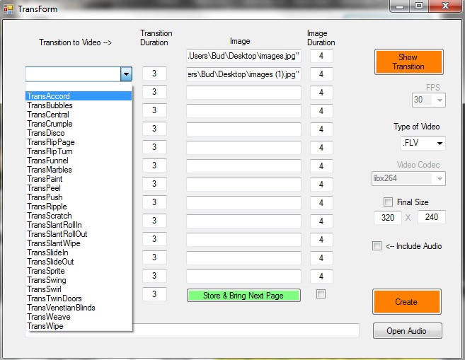

    Should there be a great demand for it, the code could be copied to a smaller version of my larger program to do just the one tab functions. It may take a couple days to debug:
Name:	ScreenHunter_190 Mar. 28 23.33.jpg

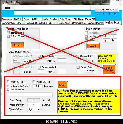

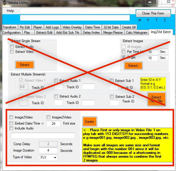

    Or if more than one image is needed with or without transitions:
Name:	ScreenHunter_190 Mar. 28 23.39.jpg

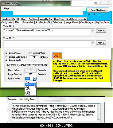

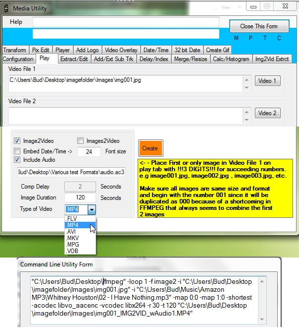

    Otherwise the ffmpeg format is like:
Name:	ScreenHunter_190 Mar. 29 16.30.jpg
