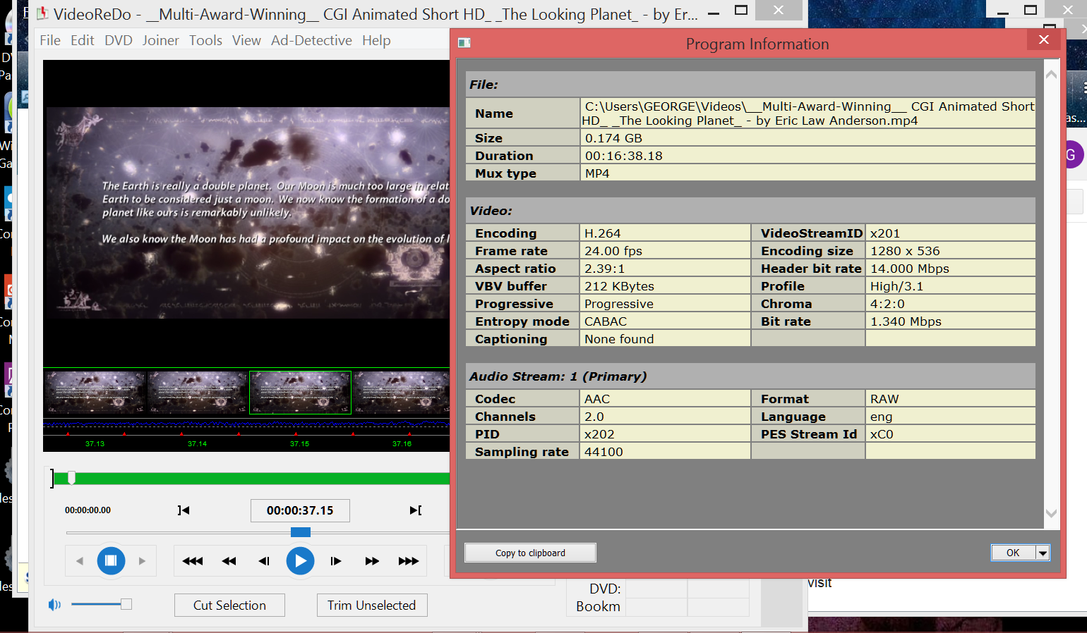

 can edit mp4, i haven't had a need to try and repair a damaged file so i don't know it can do that
