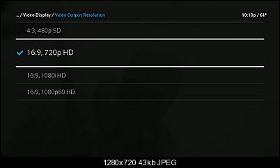

    Feb 2006
    I want to capture from my cable set top box. And yes, it has 1080p60 (see pic below).
    So let me open it up - does *any* device, internal or external, capture 1080p60 more than 2 channel sound?
  22. Member
    Aug 2006
    Your box (Comcast X1?) may output 1080p60, but no US cable company I've heard of actually broadcasts anything at 1080p60. None even broadcasts movies at 1080p24, like DIRECTV CINEMA does. Even in the small number of cities where a cable service has transitioned to H.264 for HD channels, the highest resolution actually broadcast is 1080i59.97. Deinterlacing and upscaling algorithms can only make an educated guess at what information is missing. They cannot make 1080i59.97 video look the same as if it were filmed and transmitted at 1080p60. You might as well capture at the native broadcast resolution for smaller files and use a video player with decent upscaling and deinterlacing.
    The only other prosumer device that I have heard of that captures 1080p60 and 5.1 channel audio is an internal device, the Blackmagic Design Intensity Pro 4K. It encodes using software, and is not a good choice for the inexperienced, or those using an older system for capturing video.
  23. Capturing Memories dellsam34's Avatar
    Jan 2016
    Record at the source resolution and frame rate, deinterlacing is not a good idea unless you know that your DVR chip is doing it the right way and that requires a lot of technical skills.
    The screen shot that you posted is the DVR display resolution, it doesn't mean that the DVR will record in 1080p.
    So let me put it this way, If your cable box is not a DVR type, you will have to spend some money there is no way around it, Either you buy a third party DVR and you only record clear cable, Buy a TiVo for few hundred dollars and pay one time for lifetime DVR or pay monthly, and if you want to use EPG for recording there is few more bucks a month for that service as well, The last option is buy or lease from your cable company a DVR box and pay monthly DVR fees and lease fees if you don't pay upfront for the box.
    And that's why the number of cord cutters is increasing.
