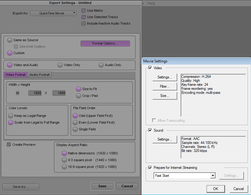

You can export directly to h.264 in a .mov wrapper, but because it uses the Quicktime engine it is painfully slow.
[Attachment 36320 - Click to enlarge]Last edited by smrpix; 26th Mar 2016 at 13:39.
SMRXP: Thank you I'm going to try MOV. it normally text 30 min so I'm scared. Hoping there was another way. That screen shot is VERY HELPFUL!
JVRaines: So would I export a file as an mpeg? Then download Handbrake on my computer and import it in there? I've never heard of handbrake before.
thank you for your help! -
If I did an AVI File, And used a different type of Codec/compressor would it help? The preset is to microsoft 1.
HandBrake is a video encoding app that uses the x264 library to make high quality compressed files. I would try exporting a QuickTime Reference movie from Media Composer (which should be quick and use much less disk space) and then loading it into HandBrake to make an MP4 file with your desired quality settings.
The "Microsoft 1" codec is good for basically nothing these days.
Tell us what codecs you have installed (listed in export dropdown).
Reference QT movie isn't a bad idea, but doesn't normally work with VFW or Directshow apps in Windows.
Would need to add a shim, like LAVfilters, QTdshow source filter, etc.
