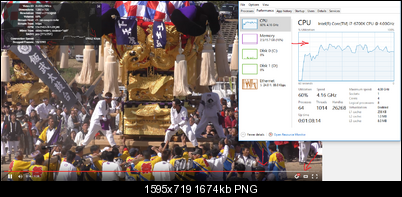

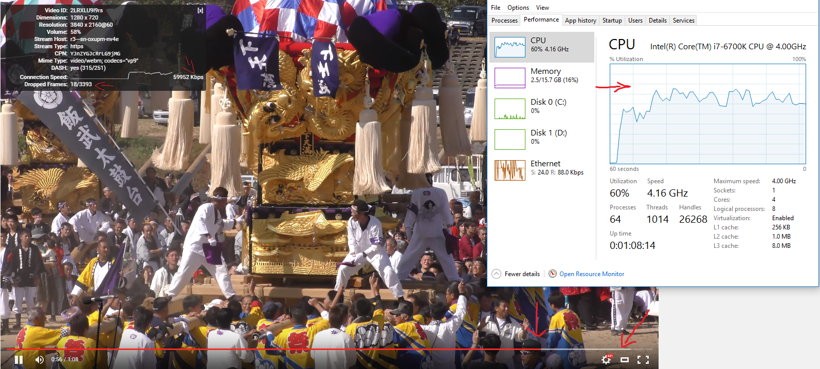

  1. I use the HTML5 player dropped frames counter
  2. Click image for larger version
    https://www.youtube.com/watch?v=2LRXLU9l9rs
    (Another video) I know, but the dropped frames counter in Firefox doesn't work. That's why I asked you if you can try and play the video with Chrome.
    By the way, I just watched the same video in 720@60P and I got 22 dropped frames.. so it's not the resolution, it's the frames per second that cause those jumps and skips. Most likely, anyway.

  4. Thank you for testing with Chrome. I got 7 dropped frames right now @2160p, and I got 12 in 720@60p. Hmm, what are your thoughts on that? Sometimes I'll get 19 on the same video, sometime a lot less.
