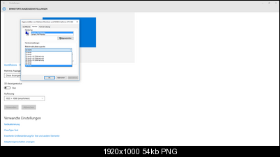

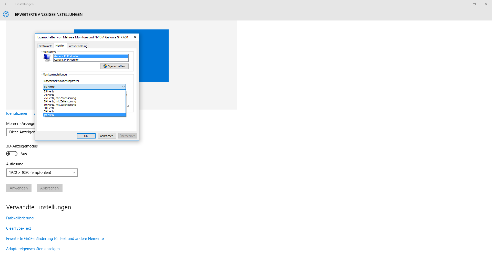

    At first we check, if the equipment supports different refresh rates like 50 Hz here:
    If there is only 60 Hz, we should try a HDMI connection. DVI-D and HDMI uses the same signals, but HDMI supports HDCP and supports all audio formats you can bitstream to your receiver like I do, DTS-HD MA, DTS-HD HR, Dolby Digital, Dolby Digital Plus, Dolby TrueHD, PCM, ..
    I had used another monitor in the past which only supported 60 Hz over DVI but all refresh rates over HDMI, so worth a try. If that doesn't help, you're out of luck and must look for another monitor-tv or TV.

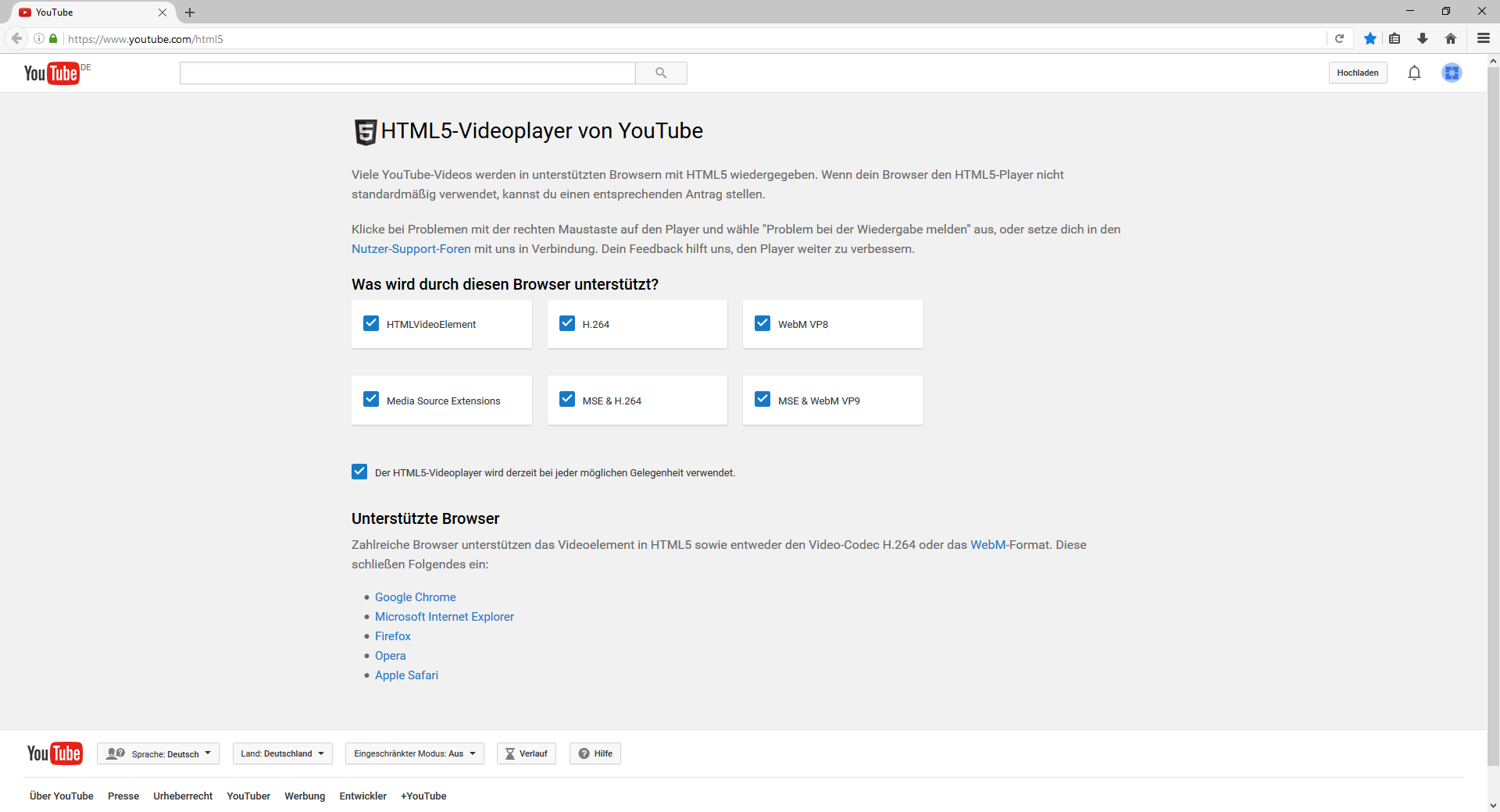

    For trying Firefox HTML5:
    please visit:
    https://www.youtube.com/html5
    Are all formats checked? If not let me know there is a setting to adjust that in firefox.

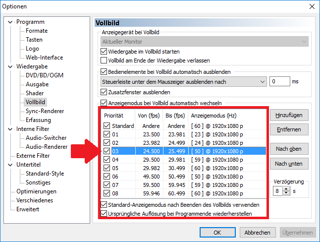

  13. Hello again, thanks for taking the time to help me out!
    First - I got an HDMI cable. Now I have more options, look - http://postimg.org/image/m3ub71w9v/
    Which one do I choose from the list? Currently it's on 59hz.
    Then, I installed MPC-HC from your link. All V-Sync options enabled. I also checked "Enable YADIF".
    Some of the videos still stutter sometimes, because when I click CTRL + J the green and red line are not always together, look -
    http://postimg.org/image/m4ibyscnt/full/
    Here's another one, which is 23.976FPS, I think it doesn't stutter, but look at the lines -
    http://postimg.org/image/7hj2o4y3v/full/
    Also, can you give me a video sample to test? I think it would be best, in order to see where the problem is.

    No, that would be awful, click on the checkbox above the red box and click on a refresh rate to change it automatically. The Devs of MPC-HC AND MPC-BE added for me delay timer you can set up to pause playback till refresh rate is done.
    The video with 60.000 fps should be played at 60 Hz mode, if you use these settings in https://forum.videohelp.com/attachment.php?attachmentid=36165&d=1457976101 except for 23Hz and 24 Hz, because your monitor doesn't seem to support that. MPC-HC or MPC-BE already adjust the right refresh rate for you.
    One file of yours is variable framerate, you won't be able with the best equippment to get full smooth playback, because the video is coded like that.
    On my HDDs I have found a very nice file in technical view with 60.000 fps and 3840x2160p UHD. These file was encoded by guys who know what they are doing (!!)
    http://distribution.bbb3d.renderfarming.net/video/mp4/bbb_sunflower_2160p_60fps_normal.mp4
    With that file you should on every computer or player get perfect smooth playback at 60Hz which every PC can.
  20. Well, I may be wrong or tired haha, but I think those settings work for me - the bunny video runs great! I can't see it glitching anywhere.
