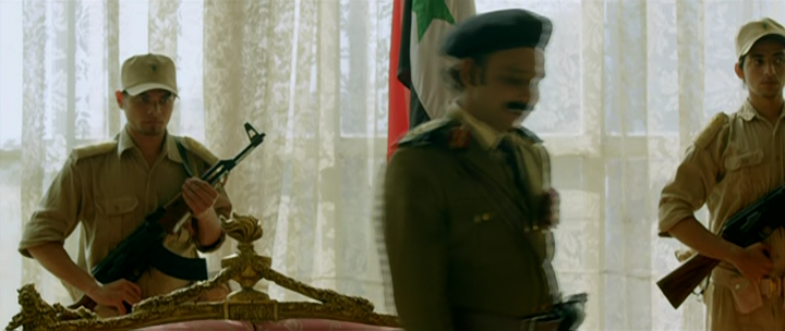

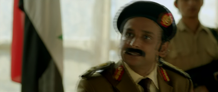

@manono
I have already tried using qtgmc and below is my result. Not perfectly de-interlaced and ghosting in between. How you have encoded it?

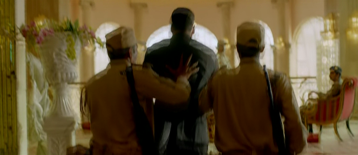

@adi10289
You seem to be resizing first, then deinterlacing which is the wrong order.
Code:qtgmc() srestore(frate=25) crop(2, 54, -2, -58) Spline64Resize(852,368) # Spline64 (Sharp)
