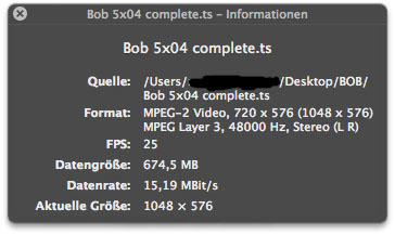

    I thought, when you have a 16:9 source, it gets stored as 4:3 (squished left+right) and then for ourput stretched back to 16:9.
    But here it is stored as 4:3 source, then anamorphic: strechted (perhaps 16:9), output: same as source.
    Does it make any sene?
    I attached Handbrake, Quicktime and MediaInfo all telling different stuff.
    I looke into this https://trac.handbrake.fr/wiki/AnamorphicGuide but am still puzzled.

  2. In general, any frame size can encode any display aspect ratio. DVD supports 720x480 (3:2, NTSC) and 720x576 (5:4, PAL) frame sizes. Those can be 4:3 or 16:9 display aspect ratio. DVD does not support any 4:3 frame size.
    The equation that relates display aspect ratio with the frame size and sampling AR:
    DAR = FAR * SAR
    Where DAR is the display aspect ratio, FAR is the frame aspect ratio, and SAR is the sample aspect ratio (distance between samles, or shape of individual pixels).
  3. OK, so I get, that there is nothing wrong with the above movie file? OK; then I just don't bother anymore. I thought Handbrake might have picked a wrong handling of the file regarding picture size.
