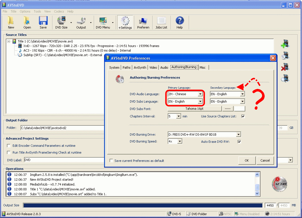

    I think I found where the audio language setting is in AVStoDVD, as shown below.
    Would you bother setting the SECOND language?

    Jan 2007
    Well... It's the subs language
    So yes I would set it
    Don't worry about that. The secondary language is used if there are multiple audio and subtitle tracks. You won't have more than one of each on this DVD.
    The AVStoDVD preferences window is for creating default/automatic settings for your project, or the default settings for all projects, if you so choose. There are also ways to override those if necessary. Look at some of the other search results.

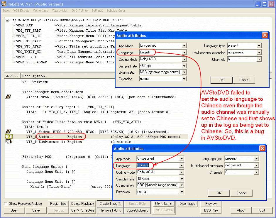

    I think you may have misunderstood my question, but that's OK because I see that usually_quiet answered the question right after you did, which was that it doesn't matter since I only have one audio channel and one subtitle file, so only the first set matters.
    I think I found a bug in AVStoDVD though.
    I am absolutely positive that I set the audio channel language to Chinese, which also shows up as set to Chinese in the AVStoDVD log file, yet, IFOEditor sees the audio channel language still set to English, so I think AVStoDVD screwed up there.
    Here is an excerpt of the log file showing that AVStoDVD "thinks" it set the audio channel to Chinese.
    DVD Audio Language (Primary): ZH - Chinese
    DVD Audio Language (Secondary): ZH - Chinese
    DVD Subs Language (Primary): EN - English
    DVD Subs Language (Secondary): EN - English
    DVD Subs Font: Tahoma 16pt (255,255,255)
    Chapters Interval: 5

    Even with the bug in AVStoDVD where it can't set the audio channel to Chinese, it's not a big deal because IFOedit has no problem setting the audio channel to Chinese.

  5. Originally Posted by usually_quiet View Post
    Thanks for that answer.
    I set both audio fields to Chinese, but, I realize only the first one matters.
    Likewise with the subtitle fields set to English.
    Maybe it wasn't a bug after all, that AVStoDVD didn't create the language setting of Chinese for the audio file.
    Maybe all I did was set the "PREFERENCE" (but not the creation).
    Anyway, I guess this problem is resolved.
