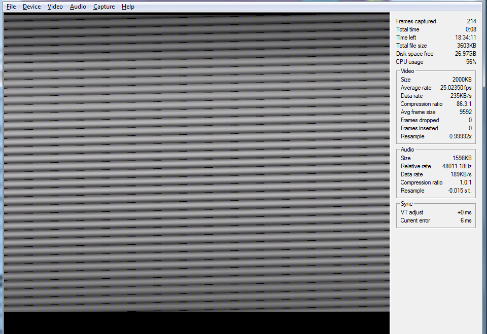

    I then downloaded Virtualdub and am using that to capture the raw video from the camera (using the Easycap interface box in between).
    But still I cannot get anything more than an image which is just full of lines!
    Here is a screen capture of the video image that I see from my camera when using VirtualDub.
    [Attachment 36262 - Click to enlarge]

    Are sure the camera is not defective? Did try to connect it to a monitor or a TV?

    I see now, Return it it's defective, The yellow connector is CVBS or composite video, It should work fine if connected to a TV with composite video IN, Keep in mind this camera is to be used for water wells or plumbing pipes, it's not meant for regular viewing, Why would you buy something before you ask the seller how it works?

    The listing is misleading, The best way is to ask the seller a direct question, they just copy paste those listings they don't know what's in them, VGA is a multi pin port never came in a simple yellow RCA plug, you should have done your homework first, Some sellers are nice to just give you a refund, some of them requires returning the item back to china and ebay requires a return tracking # to get your refund which usually costs as much as what you have paid for the item.
