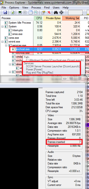

    I get inserted and dropped frames when I try to do this USB disconnect / connect during a VirtualDub capture.
    To ensure that I'm not actually using USB resources during capture and getting some sort of conflict, I tried a capture with one of my PCIe cards writing to internal SATA SSD. Then I removed nearly all resource usage by doing an uncompressed Test Capture (F7), which doesn't write to disk at all. Process Explorer reports that VirtualDub is using less than 0.25% CPU.

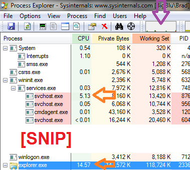

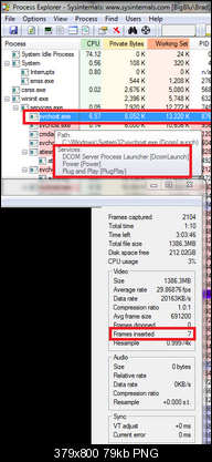

    Still, the problem remains. I see two processes that spike: an instance of svchost.exe associated with the Plug and Play service (among two others) and explorer.exe.
Name:	Dropped frames on USB event - svchost Services.png
    The purple arrow below indicates CPU usage spikes each time I pressed a button on the USB switch.
    Name:  Dropped frames on USB event - svchost + explorer.png
