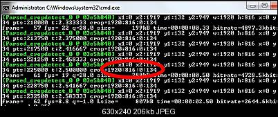

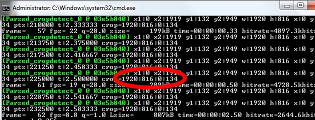

  6. First you have to check how much you should crop
    1st way FFmpeg
    First you should know about FFMpeg so if you don't first download it place it in exactly the folder where your video is and then press shift and right click then select open command window here, and in that you could type in these commands.
    For that run this command with ffmpeg
    ffmpeg -y -i yourvideo -vf cropdetect -f mp4 NUL
    then Ctrl+c it. go a bit up there you can see the resolution you should crop with so with that in mind do the next command
    ffmpeg -i yourvideo -vf crop="whatever you got from the previous command",scale=-1:480 -acodec copy -crf 18 out.mp4
    You should not type what you see in this screenshot but what appears in yours.
