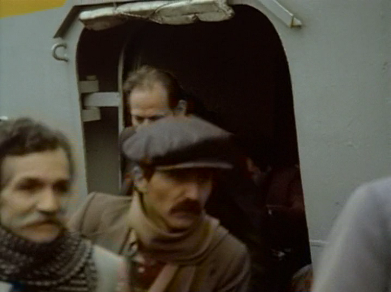

TFM() gives me this kind artifacts for sample1:
How I can rid off? It's not big scene ,I can accept little bit duplicate frames without artifacts imo.
How I can encode 50 fps with qtgmc? It's possible to use two different fps (I mean 50 fps & 25 fps) or should I use qtgmc 50 fps on whole movie ?Example would be nice.Thanks again. -
TFM() isn't causing that. You're screwing up the video before giving it to TFM. What you're seeing is interlaced chroma being treated as progressive. Post your entire script.

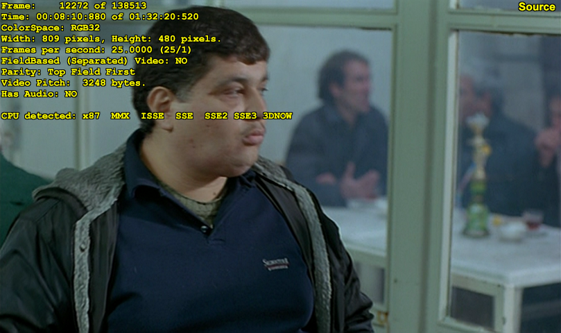

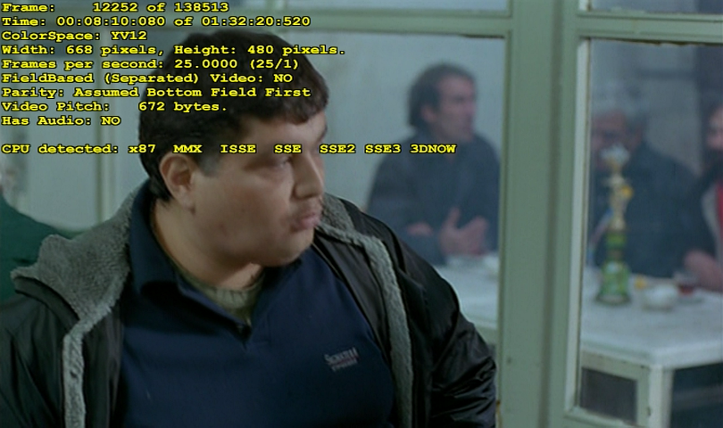

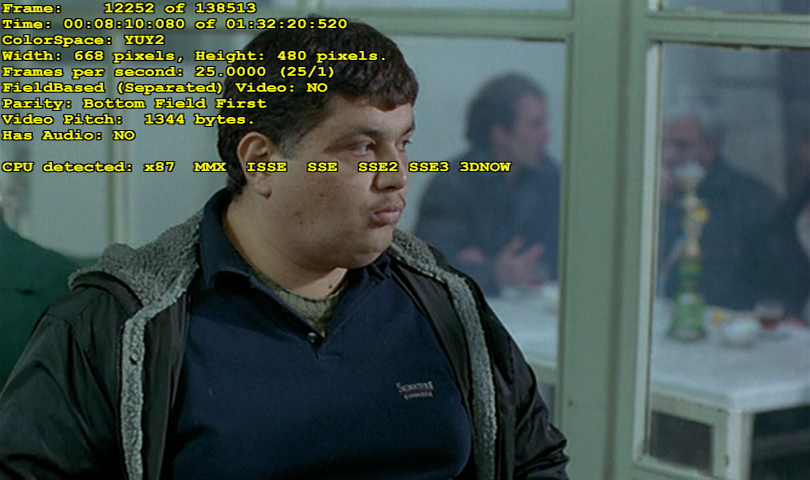

I tried the Info() for encode and source line but don't work.Encode line shows only 7 min anyway I opened them by one by via AvsPmod and it's shows properly.Here it's:
Encode:
Source(avs):
Looks like there's a only change is colorspace.But I added ConvertToRGB(), ConvertToYUY2() and ConvertToYV12() to comparison script but it's not work .And I tried many thing but no hope.
Which explains why interleaving didn't work the first time.

I guess you can tell those two frames aren't the same even though the Info says they're the same frame number. Apparently the two videos began at two different places in a longer video and if you really want to compare the exact same frames, you should align the frames better.Last edited by manono; 30th Mar 2016 at 23:12.
