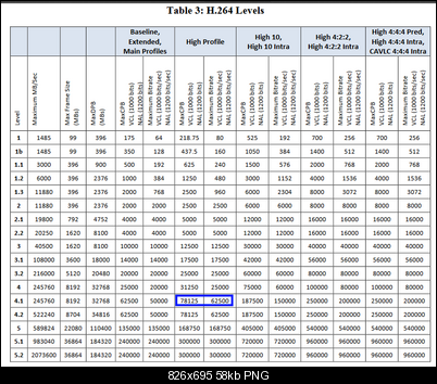

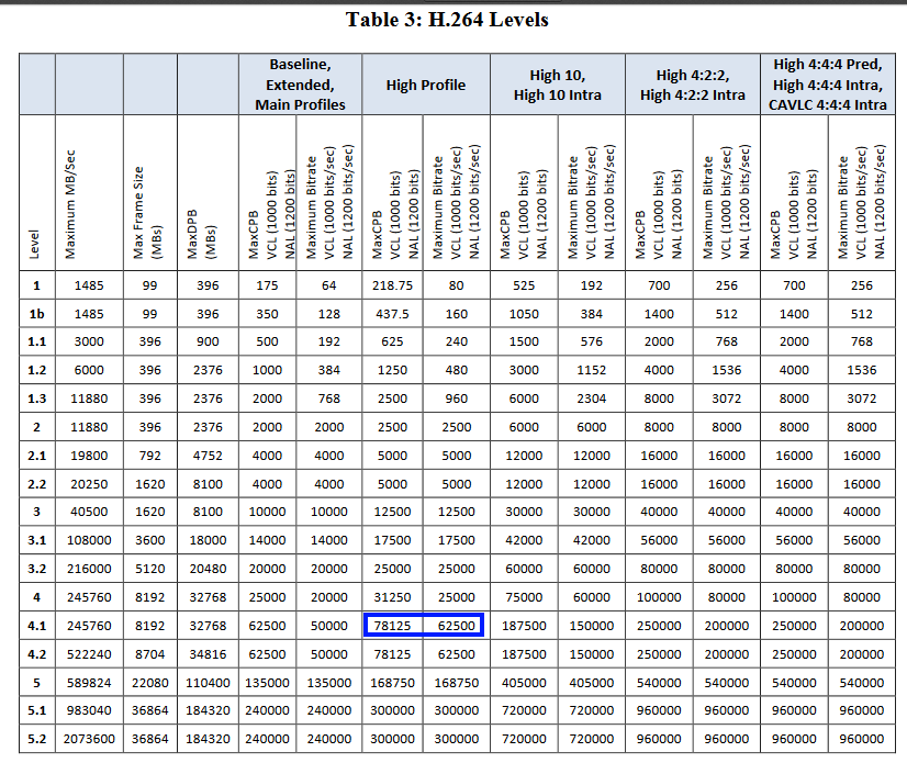

  11. Thanks for the replies. So is there anything I can do with the file in my first post with mkvtoolnix to change some settings so it can play?
  12. Dinosaur Supervisor KarMa's Avatar
    Jul 2015
    US
    That 1st clip info posted (the one that wouldn't play) has WAY TOO HIGH vbv & maxbuff sizes (well above blu-ray standards), so it's no surprise it would have trouble in a blu-ray player.
    My guess is that whoever is creating these encodes is "cherry picking" the settings to be seemingly efficient, without truly understanding their implications.
    The container, the codec, the layer/profile/level (and thus bitrate range), the framerate, the color subsampling, and the vbv/maxbuff are all important variables, whether the device/app in question specifies them or not.
    All of the x264 settings used, conform to High@L4.1 of H.264. This has become seen as the highest/most-compatible profile and used for just about every HD x264 video I see. Even my Chromecast can play High@L4.1, as stated on their website. For this Bluray player I can't get any hard details on what profiles they support with H.264. If this Bluray player can't at least deal with High@L4.1 then that would be disappointing compared to most USB Blu-ray players and TV Media Players.
  13. Member Cornucopia's Avatar
    Not VBV it doesn't (conform), especially not for hardware players (blu-ray or general media). That would likely cause a buffer OVERFLOW.
    Again, I didn't just say bitrate. I didn't just say Level/Profile. There are other important factors. VBV is one of them, particularly WRT memory-limited devices.
  14. Dinosaur Supervisor KarMa's Avatar
    Jul 2015
    US
    Seems to at least for H.264 in general for High@4.1
Name:	H264 Levels.png
    Source: http://www.gwg.nga.mil/misb/docs/trm/TRM1404.pdf
    Anyway these values are pretty commonly used. When using the High@4.1 profile in Megui, it will tack on the --vbv-bufsize and --vbv-maxrate
    program --level 4.1 --preset slower --bitrate 1000 --deblock -1:-1 --keyint 300 --min-keyint 25 --vbv-bufsize 78125 --vbv-maxrate 62500 --output "output" "input"
    When using x264 through CLI (with avs4x264mod.exe), using the settings
    avs4x264mod --level 4.1 --preset slow --bitrate 1000 --output out.264 in.avs
    I get a video with seemingly no vbv-bufsize or vbv-maxrate.

    Encoding settings                        : cabac=1 / ref=5 / deblock=1:0:0 / analyse=0x3:0x113 / me=umh / subme=8 / psy=1 / psy_rd=1.00:0.00 / mixed_ref=1 / me_range=16 / chroma_me=1 / trellis=1 / 8x8dct=1 / cqm=0 / deadzone=21,11 / fast_pskip=1 / chroma_qp_offset=-2 / threads=9 / lookahead_threads=1 / sliced_threads=0 / nr=0 / decimate=1 / interlaced=0 / bluray_compat=0 / constrained_intra=0 / bframes=3 / b_pyramid=2 / b_adapt=2 / b_bias=0 / direct=3 / weightb=1 / open_gop=0 / weightp=2 / keyint=250 / keyint_min=23 / scenecut=40 / intra_refresh=0 / rc_lookahead=50 / rc=abr / mbtree=1 / bitrate=1000 / ratetol=1.0 / qcomp=0.60 / qpmin=0 / qpmax=69 / qpstep=4 / ip_ratio=1.40 / aq=1:1.00
    Seemingly having no limit. I also don't believe a ABR of 2713kbps should be able to come close to stressing a Bluray player, maybe 2-Pass on certain exceptional videos but ABR is just not that efficient at spreading out the bitrate. Maybe this player just does not support the High Profile.
