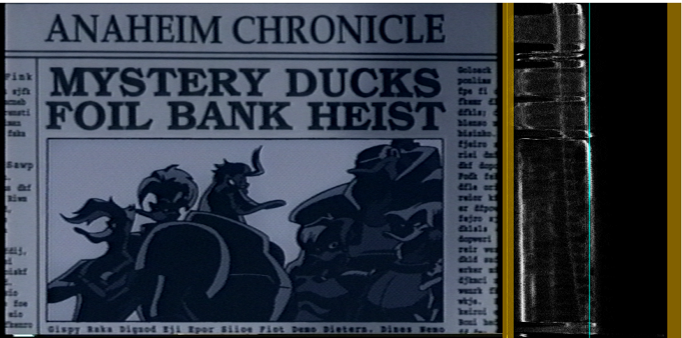

Just a couple quick observations at the moment. So far, I feel like I set my money on fire.
Note: you should be able to zoom the screenshots with CTRL and + (thanks, jagabo).

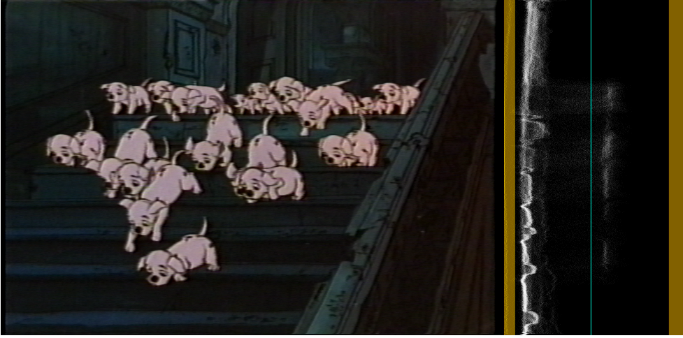

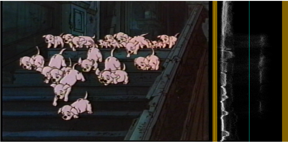

SP mode retail cartoon, with Macrovision
On the left is JVC HM-DH5U set to EDIT. The rest are all PV-S4670, run through different devices to see how they handle line TBC when Macrovision is present (specifics are in the filenames). The most obvious TBC issues are the top curl with the AVR-890 and the bottom shift with the DVDR3575H.
Note the "downward smudge" effect on the PV-S4670. Manual lists Color Noise Reduction and "Advanced Noise Reduction" for luma NR.
Name:	MDTM Dalmatians stairs - HM-DH5U =HDMI= C127.png
ID:	36234 Click image for larger version
Name:	MDTM Dalmatians stairs - PV-S4670 =YC= JVC HM-DH5U =HDMI= C027.png
ID:	36233 Click image for larger version
Name:	MDTM Dalmatians stairs - PV-S4670 =YC= DVDR3575H =HDMI= C027.png
ID:	36236 Click image for larger version
Name:	MDTM Dalmatians stairs - PV-S4670 =YC= Denon AVR-890 =HDMI= C127.png

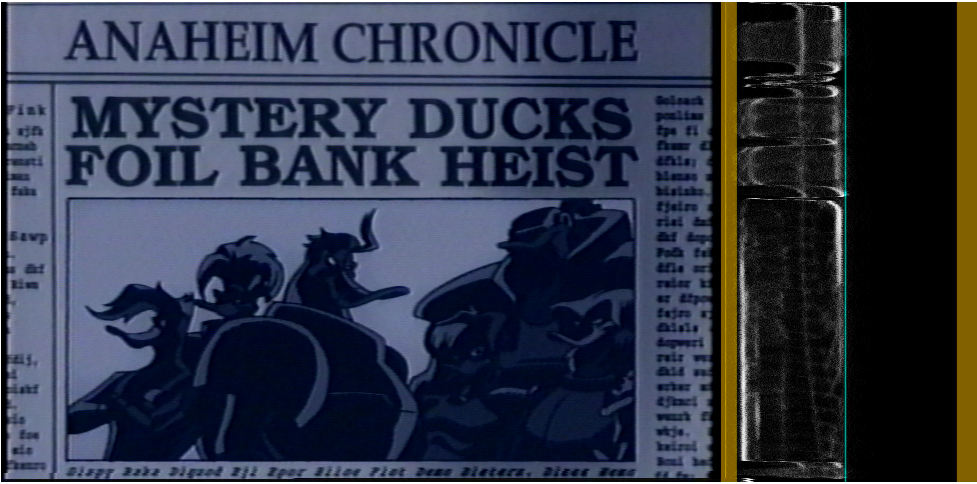

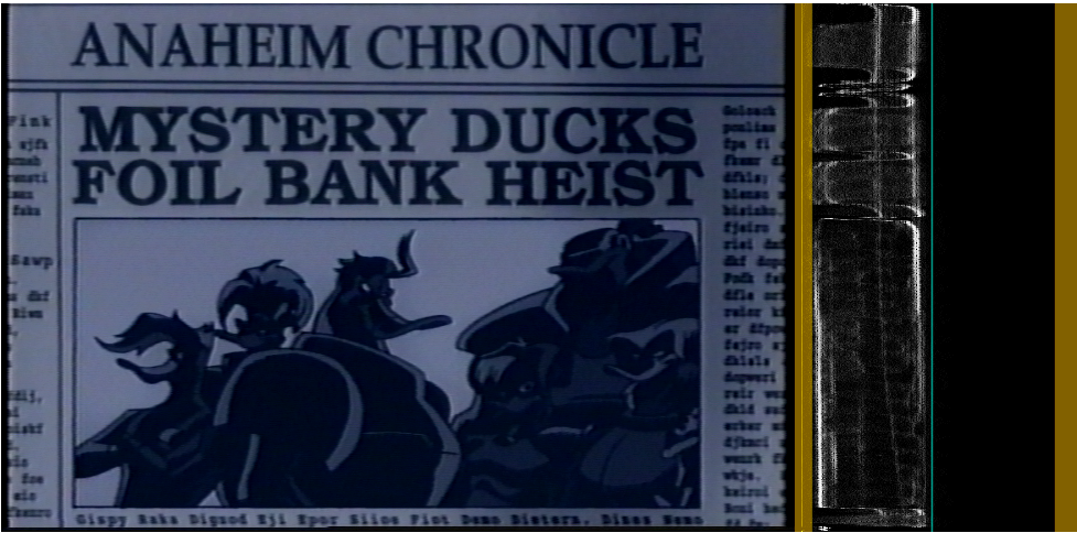

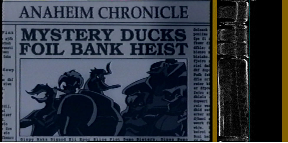

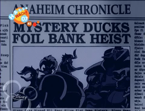

The dots in the newspaper photo below are smeared away.
Name:	MDTM newspaper - Ep 1 DVB-DivX.png
Name:	MDTM newspaper - HM-DH5U =HDMI= C127.png
ID:	36241 Click image for larger version
Name:	MDTM newspaper - PV-S4670 =YC= JVC HM-DH5U =HDMI= C027.png
ID:	36240 Click image for larger version
Name:	MDTM newspaper - PV-S4670 =YC= DVDR3575H =HDMI= C027.png
ID:	36237 Click image for larger version
Name:	MDTM newspaper - PV-S4670 =YC= Denon AVR-890 =HDMI= C127.png
EP mode is oversharpened with ragged edges (no sharpness control). That will have to wait for another day, though.
