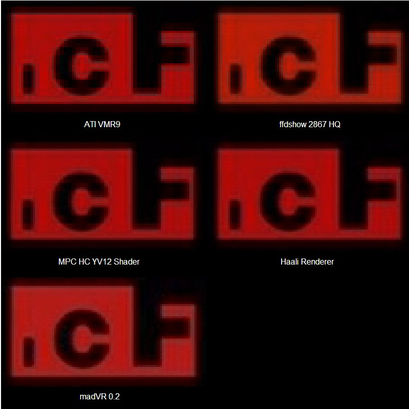

but werent you watching BluRay 1080p sources? in which case NO upscaling takes place and therefore NO difference in PQ - Ive seen a test set and could clearly see the difference, finer/smaller macroblocks possibly giving better edge sharpening
I using Windows 10 - MPC-HT from K-Lite Megapack on its default settings....im quite savvy with these sort of things, would be willing to give it a try -
That's normal, most people will not see much of a - or any - difference. It's for videophiles.
That is not true. All consumer formats use chroma-subsampling. On a BluRay the luma plane is 1920x1080 but the chroma planes are only 960x540. madVR will upscale the chroma planes to 1920x1080, if wanted apply additional filters, convert to rgb and then dither the result to the output depth.
Iam a Videophile (mediocre - know more than retail sellers put it that way lol as I used to work in a top UK Electronics/TV store and couldnt believe the crap they come out with AND stuff they didn't know) and I know what too look for... ive seen test sets below which show MadVR showing finer macroblocks resulting in better sharpening and probably finer edge sharpening etc
