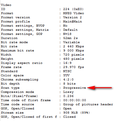

  7. Just posted a few minutes ago another thread about convertxtodvd making a progressive 29.97fps video which I thought was not allowed on DVD, however I just found this thread so I ran the above command line on my 59.94fps progressive source and I got the same "progressive" designation from mediainfo. I think convertxtodvd uses ffmpeg so it makes sense I got the same thing, but is it legal on a disc?
    I can't figure out how to create a 29.97fps progressive file from a 59.94fps progressive source without dropping frames causing jitter? This command line is doing it but how would I do it manually? I used HCenc to create a 29.97fps interlaced DVD earlier via avisynth using manono's script above but it has more visible interlacing artifacts than the output from this ffmpeg command line.

  9. I should have mentioned I saw the artifacts on my PC when I had de-interlacing turned off, so I saw even less artifacts with ffmpeg but maybe it is being filtered too much like Pandy said above. He didn't specify the other filter he mentioned either.
    Here is a link to the convertxtodvd output, the same as ffmpeg command line gives above. See if you can verify that it actually is 29.97fps progressive!

  10. Originally Posted by tyee View Post
    I should have mentioned I saw the artifacts on my PC when I had de-interlacing turned off...
    You know how that sounds, don't you? You're complaining about seeing interlacing when you played interlaced DVD video without a deinterlacer turned on? Have you played it on your television yet?
    Yes, your sample has progressive content encoded as progressive.
