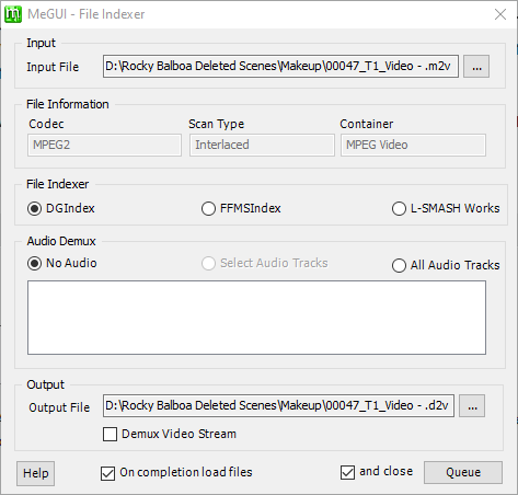

    Thank you again for your response but I have a few questions still.
    I noticed you have the d2v file loaded or "dragged" in after TFM. Is that required? I always thought just having it once at the start was enough. Also I was using D2VSource instead of Mpeg2Source. I believe D2VSource is frame accurate but I could be wrong.
    I used DGIndex in MeGUI but it didn't have the option for honor pulldown flags
    [Attachment 59924 - Click to enlarge]
    Lastly, any word on the audio and trimming? Should it all sync up with this new script now?
    EDIT: Did a quick encode, everything appears to be working, thank you so much!
