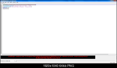

    Followed ALL advice given and this is the error I get.
    When I installed the runtime package, it got to 100% and didn't get to the next screen. I waited 10 minutes and nothing happened (I have an SSD as my windows drive so it's not my computer being slow)
    In programs and features it showed it was installed, so I closed it and restarted my computer.

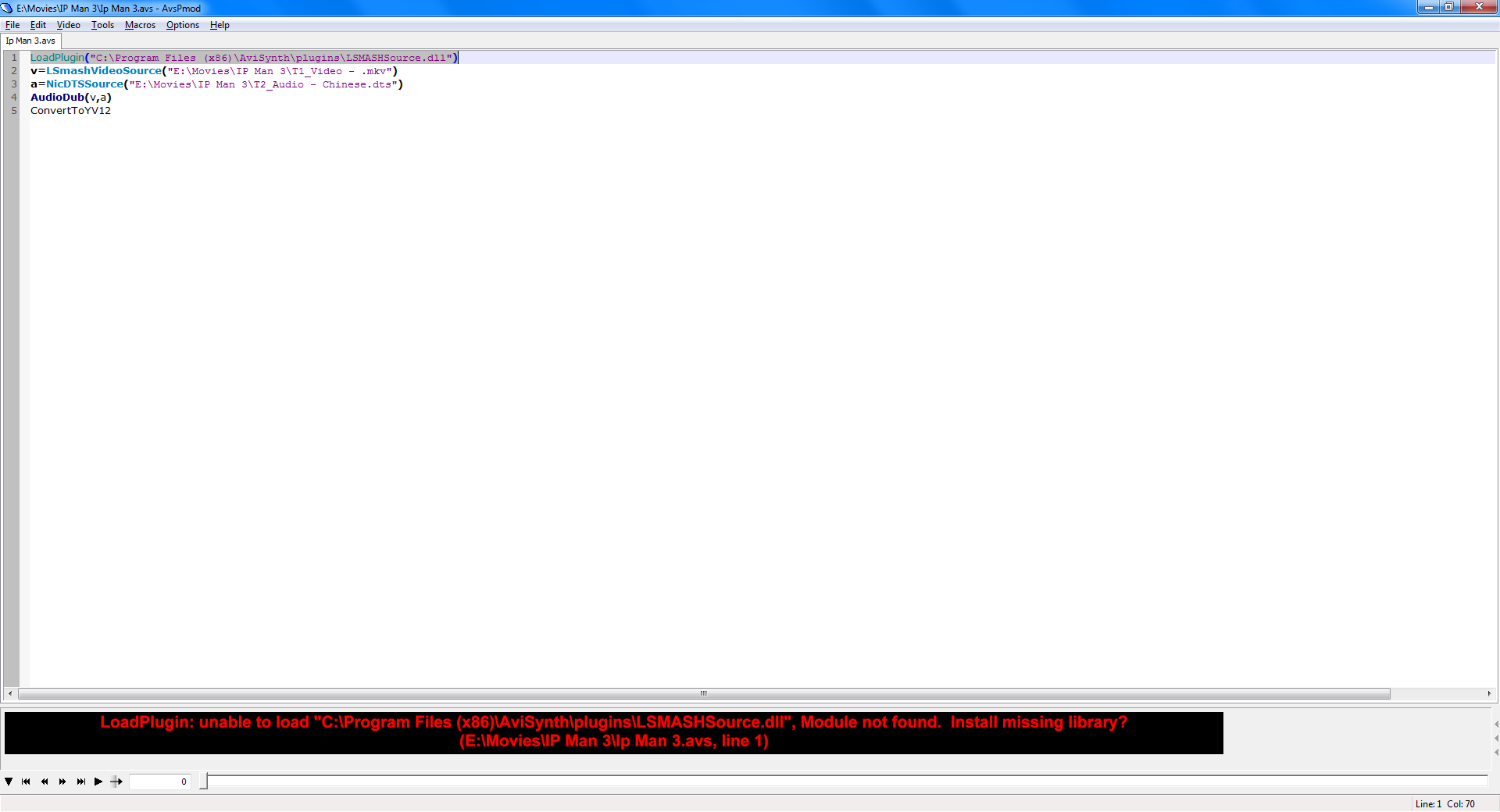

    That error message is telling you exactly what's wrong. LSMASHSource.dll is not in the indicated folder. You need to change the path to indicate the correct folder.
    I changed the path, still not working.
    Nope, not true. That error message lets you know that a support library is missing for LSmash, most likely a VC runtime. I suggest to run AVSMeter with the switch "-avsinfo" to see what's missing.
  27. I got exactly the same message when I deleted the dll and tried to LoadPlugin() using the original path/name. Or any time LoadPlugin() is used with a non-existent dll specified.
    But I just checked, it gives the same error if LSMASHSource.dll is present but msvcr120.dll is missing from the system dlls. WAusJackBauer can get the MSVC libs via the links at the LSMASHSource page at the AviSynth wiki:
    http://avisynth.nl/index.php/LSMASHSource#Requirements

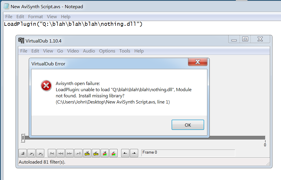

    You must have a very special Avisynth version. This is what I get when loading a script with a LoadPlugin() call to a non-existent DLL:
    Cannot load file 'E:/test/aa.dll'. Platform returned code 126:
    The specified module could not be found.
  29. Because MeGUI is mentioned in the thread title I didn't look and assumed LSmash was in MeGUI's "tools\lsmash" folder. MeGUI also puts a copy of msvcr120.dll in that folder so there's no dependency problem.
    Re the error message:
    I don't think the Avisynth version I use is all that special, but here's what happens when I ask it to load a non-existent dll.
    I generally get the same error if a dll can't be loaded due to a missing dependency. I'm not sure I've ever seen the error message Groucho2004 posted. Obviously it exists, so I wonder why Avisynth displays different error messages?
