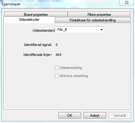

  14. Ah, sorry. Here is when I have selected the ATI 750.
    The numer for the "Identified lines" jumps from approx 300 to 625.
