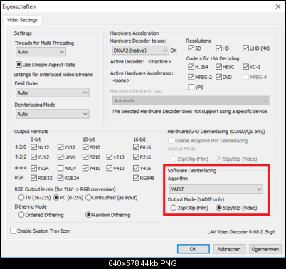

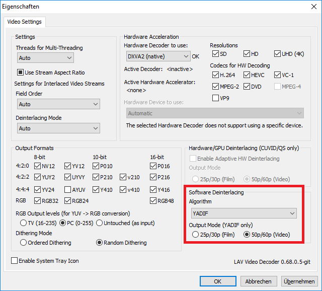

  6. I don't know if I get it right but for playing videos smooth on a computer:
    There are several things that cause the non-fluid look. At first you must look for a good Videoplayer. I use MPC BE, you can also use MPC HC which has already integrated LAV Filters, for beginners a bit easier, no need to add external filters.
    In the video settings of the LAV Filters you must select:
    This was the first thing to get the advantage of interlaced 25 fps which has a temporal resolution of 50p.

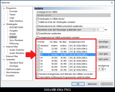

    But to get fully smooth video playback you must have a monitor or TV that supports other framerates than 60.000p. Then configure in MPC BE or MPC HC:

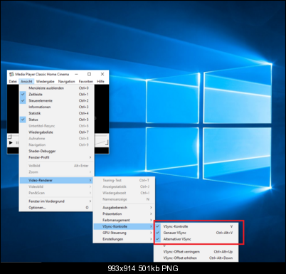

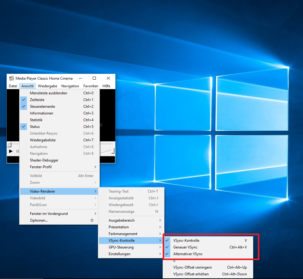

    Also important is to use that:
    While playing press CTRL + J and you can see a red and green line that should be parallel ...
