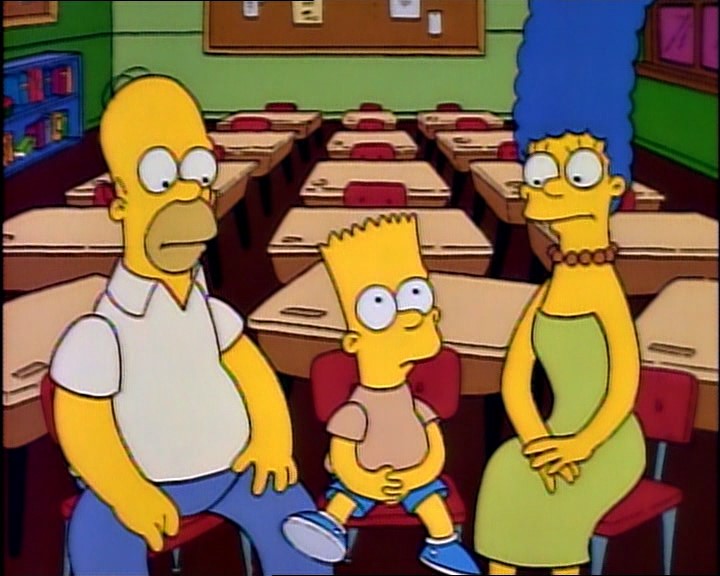

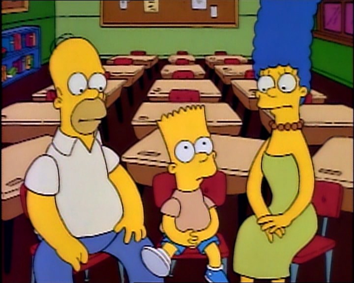

  7. Tried a few different ways and in different combinations and the results are similar again. Almost all of the problem is removed from the roof scene, but the desk scene still has the blending problem. It smoothly moves from one placement to another when in reality the lines should be static. I did however scrub through the source and find what I believe to be the problem. In addition to the artifacts I've previously mentioned, every now and then there's a frame transition like this:
    Perhaps the pixelated nature of the frame is interfering with the filters doing their job completely? I managed to get my hands on a broadcast version of this episode and the problem I have is still present, could it be a fault with the original animation perhaps?
