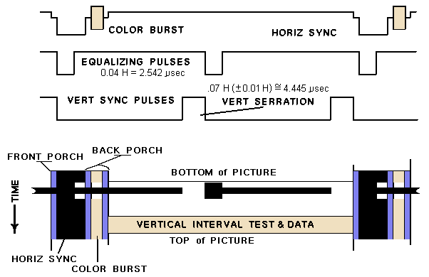

    The short low state of an equalizing pulse is not the same length as the short high state of a sync pulse.
    The long high state of an equalizing pulse is not the same length as the long low state of a sync pulse.

    How long (accurate to 1/10th of a microsecond) is the duration of the low state of an equalizing pulse?
    How long (accurate to 1/10th of a microsecond) is the duration of the high state of an equalizing pulse?
    How long (accurate to 1/10th of a microsecond) is the duration of the low state of a v-sync pulse?
    How long (accurate to 1/10th of a microsecond) is the duration of the high state of a v-sync pulse?

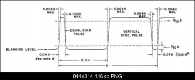

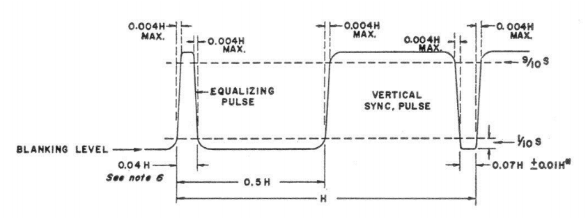

    I think this diagram (which I found here) will answer your questions. "H" is the duration of one horizontal scan line.
  4. Originally Posted by JVRaines View Post
    [Attachment 36160 - Click to enlarge]
    That diagram appears to be upside down. Equalizing and sync pulses isn't aren't positive-going pulses, but rather negative going. In fact, it's "blacker" than the blanking level, which is itself "blacker than black". Darker parts of an image are represented by lower voltages (but greater than 0 volts), and brighter parts by higher voltages, and the synchronization and blanking signals are negative voltages, or at most 0 volts. I have no idea why this graph appears to show the equalizing pulse and sync pulse being positive.
    It is if you assume it's baseband video. But this is the NTSC standard for radio broadcasting. Up is in the direction of increasing modulation. NTSC was negatively modulated so that brighter pictures, assumed to be more common than dark pictures, require less power at the transmitter.

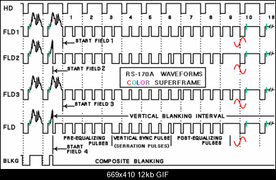

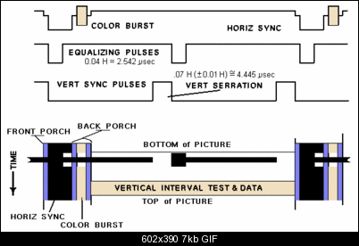

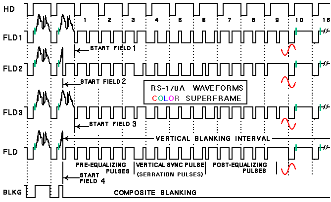

    Instead creating two fields with 262.5 line, one field have 262 lines (short) and second field has 263 lines (long), analog equipment average over time video as such proper 525 lines frame is retained. Block responsible for synchronization at receiver side is called sync slicer/sync separator/sync processor/sync stripper etc and it is capable to distinguish between odd and even fields and as such return proper time structure of video.

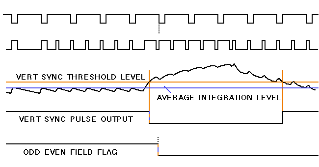

    Half line offset is created in are something called serration/equalization pulses http://www.ntsc-tv.com/ntsc-index-02.htm look at those 5 diagrams - notice subtle duty ratio differences between each field (there are 4 different fields in fact - this is important for colour processing and frequently is called 4 field sequence - as a curiosity - there is even MPEG official syntax to mark every field phase inside codec)

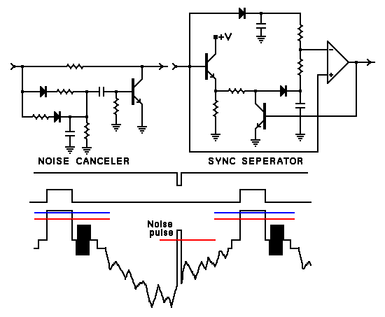

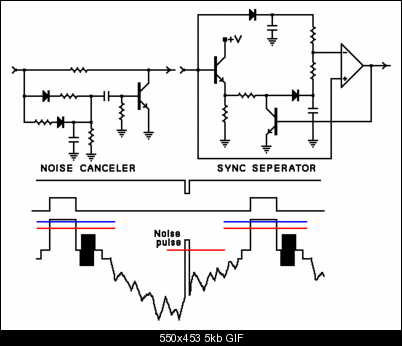

    Blanking is every signal/time that don't contain active video signal (itself active video signal may have normally visible and normally invisible part - normally invisible part is so called overscan and as already explain this normally not visible but active video purposed is to relax various devices timing requirements - this is valid for broadcast/production studio and for TV receivers) , some of blanking lines are used to carry additional information - as overall it is more correct to use blanking period as it cover both line and sync pulses - remember there is 525 Horizontal sync pulses per picture and there is few Vertical sync pulses (as such those lines used for Vertical sync can't be used to carry any other information than synchronization).

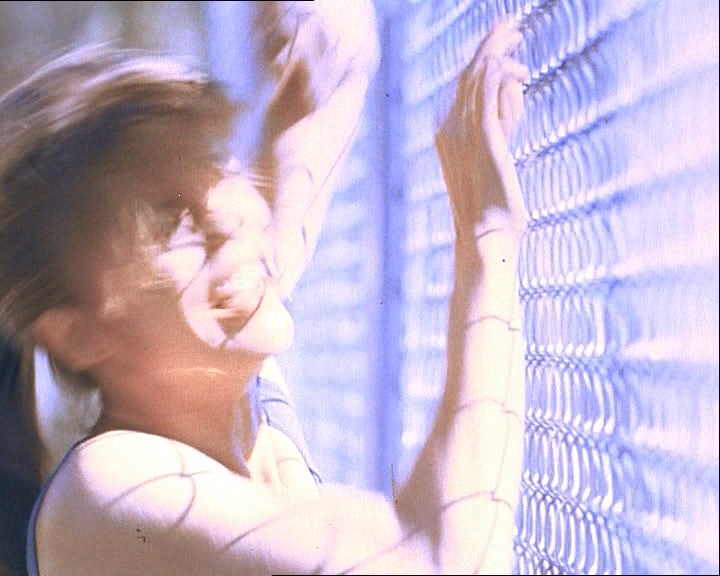

    In the analog world (525, 625), you have an extra 1/2 line at the start of field 1 and an extra 1/2 line at the end of field 2. But those are part of the blanking, so the active picture is a straightforward even number of whole lines (480, 486, 576).
    I don't believe I've ever been in a position to correct you before.

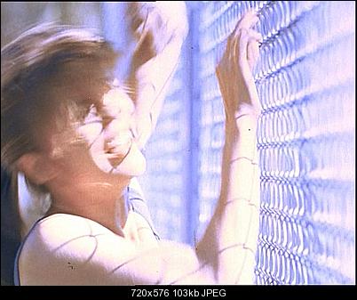

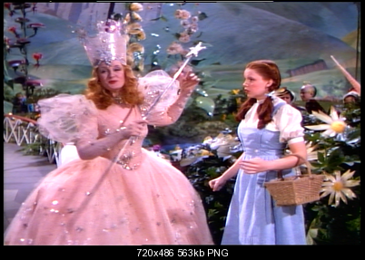

    The "active" picture area begins and ends on the half-lines. PAL is 287.5 * 2 which becomes 288 * 2 for digital. NTSC is a lot weirder, but when there are sufficient active lines from an analog source, you can see the same idea. When the source is 480-line digital, the padded half-lines are just fully "black" all the way across, so in that case I guess you could say they are part of blanking.
    PAL DVD. Note the blackness at top left and bottom right.

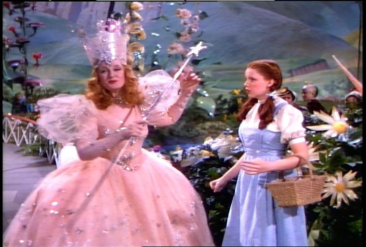

    486-line LaserDisc capture. One row of codes, one row of blackness, one half-line, 482 full rows, final half-line.

  16. Member Cornucopia's Avatar
    I should have said, "for NTSC analog video, the extra 1/2 line starts at the beginning of the even field in the top center and the other 1/2 line ends at the end of the odd field at the bottom center". Depending on whom you believe, active picture for analog NTSC could have been anywhere from 480 WHOLE lines (with 22.5 blanking lines per field) through 487 lines (with 19 blanking lines per field). Supposedly valid equipment sources, including manufacturers Techtronix and National Instruments, still vary in their listing, with 483 and 485 being common.
    But that was the nature of the analog beast - there was a little room for error/variation.
    Digital changed that: Active picture is all whole-line interlaced or progressive fields, either 486 or 480, depending upon the spec.
