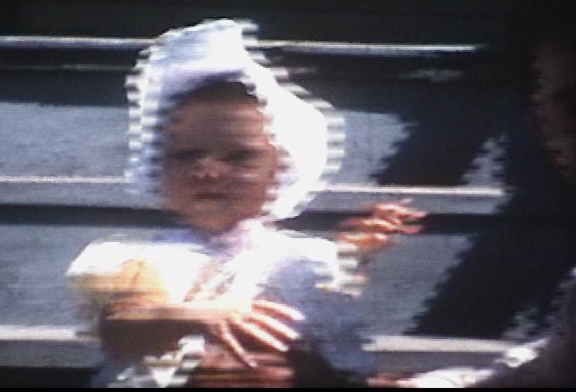

    I've read several threads on this but it's still confusing to me.
    This frame is from a burned DVD of an AVI file I made. I originally captured some of the clips from my Sony camera into WinDV, and some of them are from an old DVD that I ripped. The finished 2 hour AVI does not have these artifacts when played on my PC with VLC.
    But 2 different brands of DVD+R discs came out like this when I burned them with Nero 7. I tried the disc on a DVD player and analog TV, as well as on my PC with VLC - same thing.

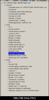

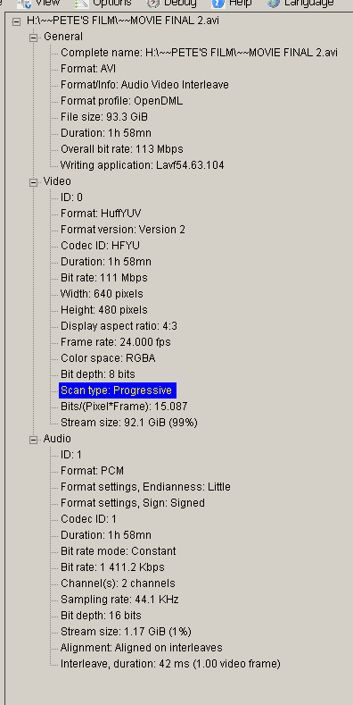

    And here's what Mediainfo says about the movie on my hard drive (not the DVD):

  2. Those artifacts are indicative of interlaced video improperly resized. Where did that avi come from and what are your DVD output settings? How does it look when played in a standalone DVD player? (It has nothing to do with the burn process.)

  6. Probably VDub. Your mediainfo shows that material that would have been captured in WinDV at 720x480 29.97fps interlaced has been converted to 640x480 24fps progressive. That doesn't happen accidentally. You must have applied some filters.
    So Nero is re-converting a messed-up file. I'm not a big fan of Nero, but I don't think it's to blame in this case.

    You (or someone somehow) resized it vertically and you improperly changed the framerate from (probably) 29.97fps to 23.976fps. In the process you ruined it beyond redemption. Unless you have your source still available.

    The major bad thing has already been described: you vertically resized interlaced video using a progressive resizing filter. But since you won't upload a sample of your source, the intermediate file you created with VirtualDub, and a sample of the VOB file produced by Nero, nobody can say where or why the problem happened.

  24. That AVI file is already messed up. The two fields (each frame of interlaced video contains two separate half pictures called fields) are partially mixed together. Given the largish black borders at the top and bottom of the frame you likely resized the video without accounting for the fact that it's interlaced.
    And since it's encoded with huffyuv nero had no way of knowing whether the video was interlaced or progressive.
    Open your video in VirtualDub and apply the Bob Doubler filter. You'll see artifacts exactly like those in your first post.
