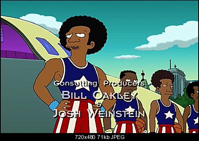

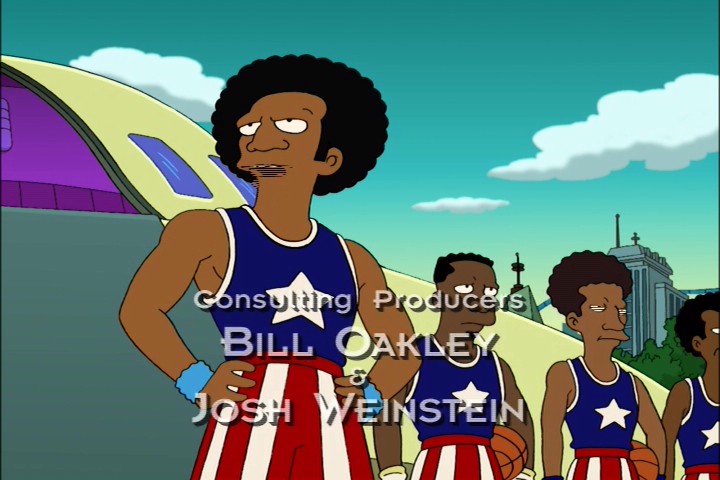

    For example, in S3.E14-FuturamaTestClip2.m1v, after Interleave(TFM...TFM) at frame 142 you'll see:
    There are combing artifacts in the first guy's mouth and the third guys eyes. That's because of the fading titles which can't be matched to any of the fields around it. Following that with TFM(field=0) gives:
    TFM decided to deinterlace the frame but now you have aliasing artifacts. Using a higher CThresh value causes TFM to let that through with combing intact (as in the first image). Further processing might have blurred the combing artifacts together (vInverse) or dropped the frame completely (TDecimate, SRestore). Or maybe you just didn't notice it.
    One way around that problem is to use another deinterlacer like Yadif(). Unfortunately, Yadif() will damage non-interlaced frames at times. But there is a way to only use it when TFM detects residual combing:
    Interleave(TFM(Mode=1,PP=0,Field=1),TFM(Mode=1,PP=0,Field=0))
    TFM(field=0, clip2=Yadif())
    vInverse()
    SRestore(23.976)
    This way, TFM will use the Yadif deinterlaced clip rather than its own deinterlacer -- but only when it detects residual combing from the earlier Interleave(tfm, tfm).
