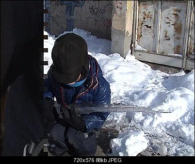

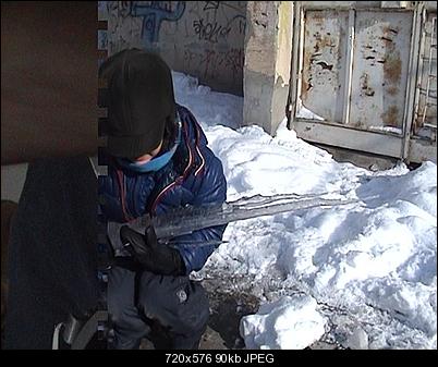

    I have a Sony DCR-HC45 miniDV camcorder that started to record on only 3/4 of the magnetic tape width.For a better understanding please see the screenshots.On the left side of each screenshot is the old recording that should have been erased, on the right side is the new recording.Also the sound is from the old recording.The ratio old/new is not consistent during the entire tape, sometimes is almost 1/2 old recording and 1/2 new.I know that the recovery is impossible and the only thing I can do is crop the video. I'm aware that is a problem with the recording head.Is there any way to fix the camcorder?Please advise.Thank you.

    PS.The screenshots are made after deinterlacing using QTGMC script.

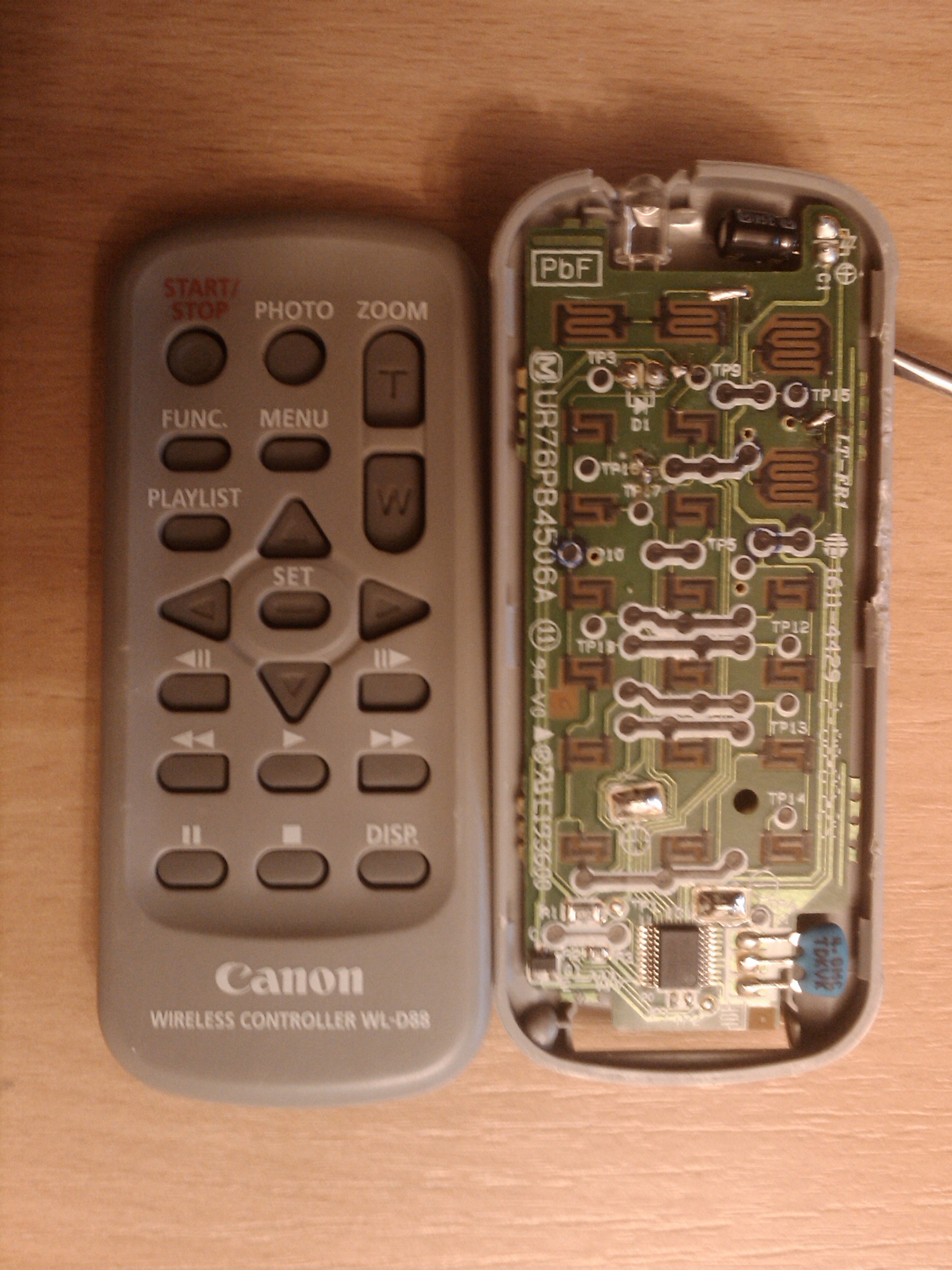

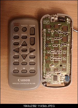

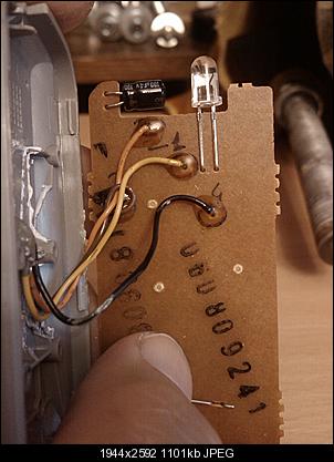

    Something like this.I did this to control the camcorder using magnetic switches in a DIY underwater housing.It's hard to adjust the housing for a new camera, I'll have to make a new one.
    Edit: sorry, this is from a Canon camcorder, I couldn't find the pics from Sony.Both are "modified" the same way.
