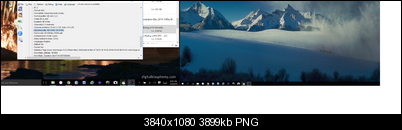

  1. The latest version had worked well with playing DTS files through receiver. The receiver still displays the DTS-HD format, however lately the receiver will not play back DTS files utilizing the Dolby Atmos Enabled Speakers. I have used a standard Bluray player and it works as should. It may be due to a firmware upgrade (which is when the problem occurred) on the receiver, I just want to try a different player to eliminate the factor of it being MPC-HC/BE, that plays DTS. Or any other suggestions would be helpful. Thanks

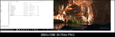

  3. Did I put these filters in the right place and our my "checks" correct?

    It did not change anything, let me try restarting the computer?

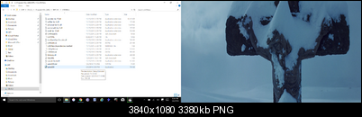

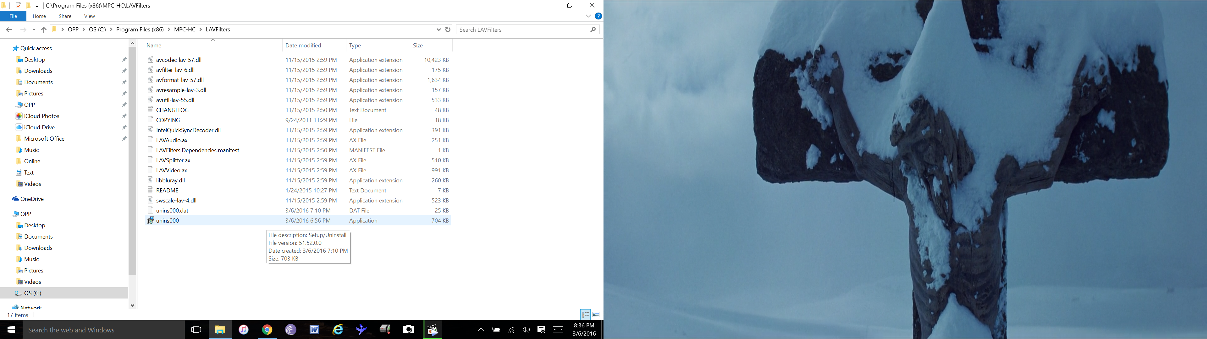

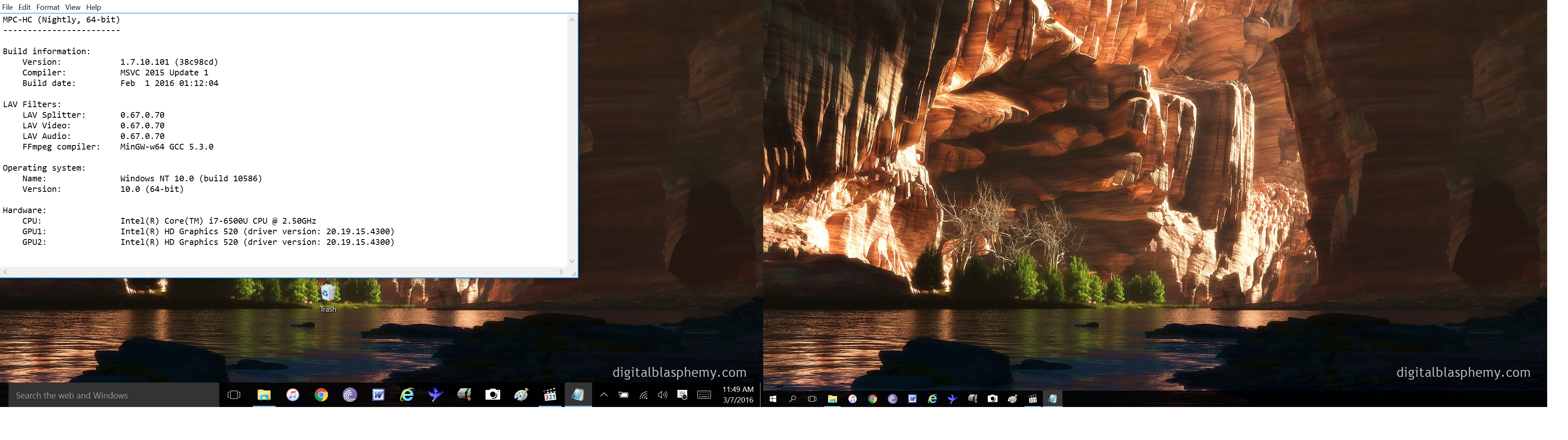

  4. now my tree looks like this
    C:\Program Files (x86)\MPC-HC\LAVFilters
    Sorry was trying to watch a movie that is currently utilizing the DAES speakers when taking screen shot. It is using Dolby Surround in 5.1.2 (7.1 speakers). The codec is

  5. Looks like old LAV filters.
    This is what i've applied to my computers.
    - installed MPC-HC latest beta
    - installed latest LAV Filters beta
    - manually copy proper files from LAV filters folder to LAV Filters folder in MPC-HC
    At this moment i have same version of the LAV Filters on system and on MPC-HC (as MPC-HC use local instance for LAV Filters).

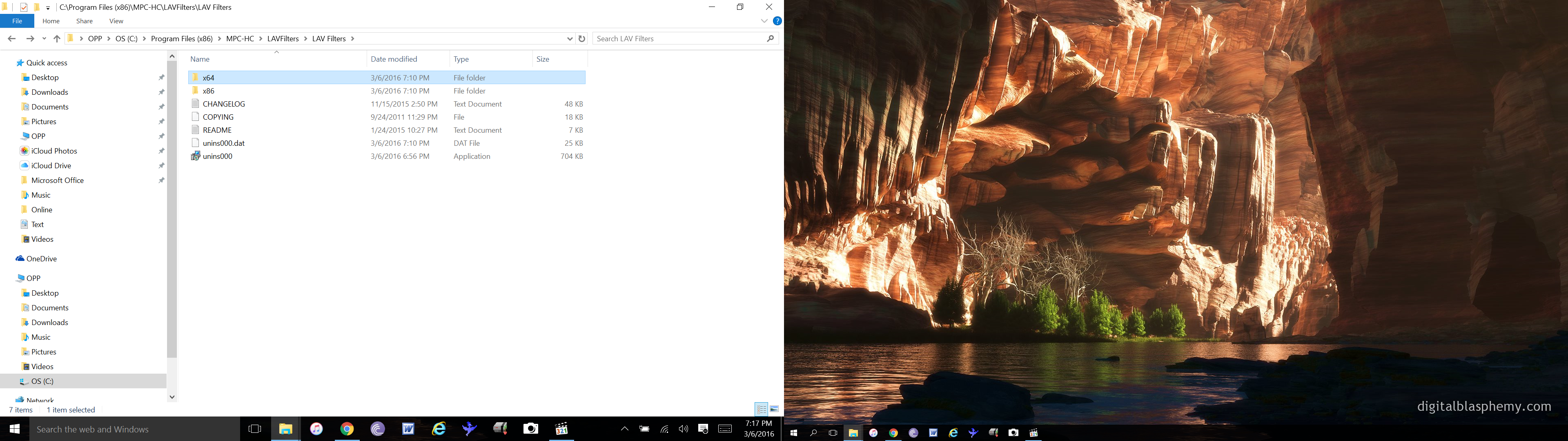

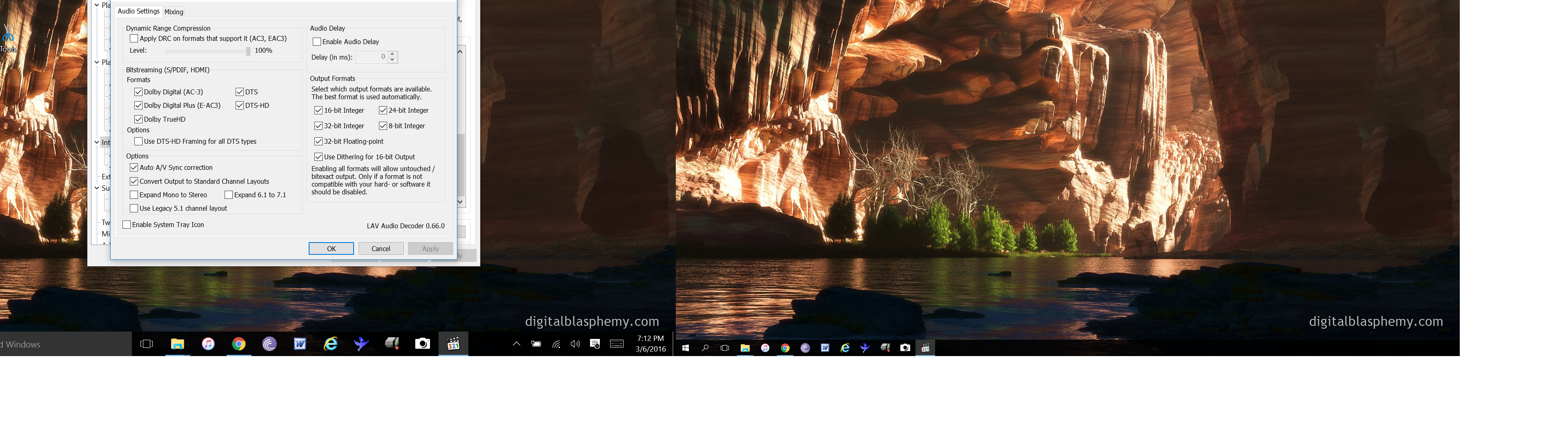

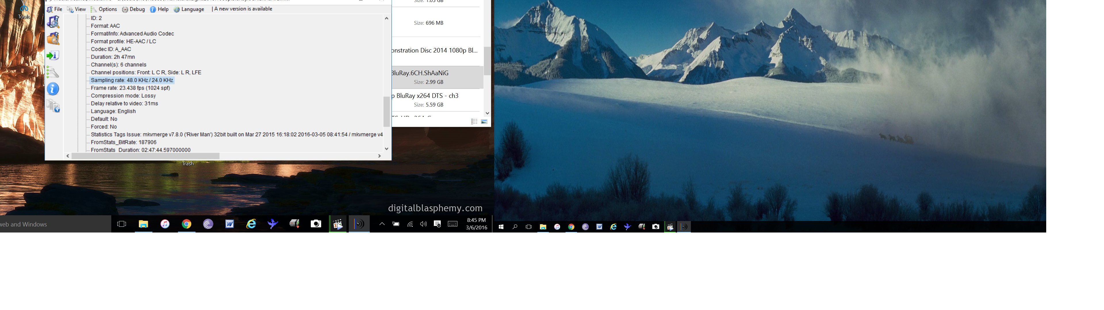

    Cool. I believe we are on the same page. However please answer do you currently have this working on your system? ( DTS files being utilized through Denon or applicable receiver by DAES speakers or all speakers active?) I have reinstalled. I believe these are latest versions beta of both. I cut and paste rather than copy, I dont think that would make a difference since you are overriding. Here is new info. Still not working. Still displays proper DTS-HD on receiver only playing out of 5.1 .Click image for larger version

  9. I talked to Denon today, they have not fixed it yet. I am pretty sure the issue is with them. Your input is still useful.
    "Regarding your issue, there is currently no way to output to your Dolby enabled speakers using the Front Dolby or Front Height channels while playing back a DTS HD MA track. This is due to the impending DTS:X update the X1200 will receive in the near future." -Denon
