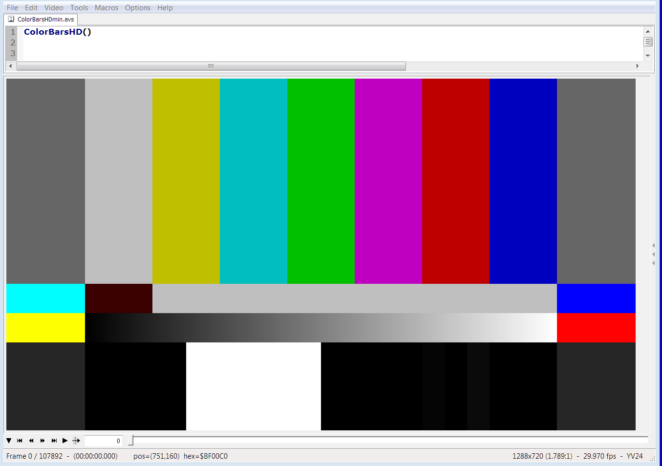

  1. I've been trying to work out why You Tube changes the colours of some of my uploaded clips....
    If I create the single line Avisynth script "ColorBarsHD()" and open that in AvsPmod with the default YUV->RGB video settings -
    (i.e Resolution based - TV levels - Progressive)
    then the resulting video file displays correctly on my monitor, with the 75% levels as outlined in the attached spec sheet. And all the B&W and greyscale levels are right too.
    But try as I may -- and I think I have tried every combination of colourspace conversion and file format I can think of - I cannot get those bars to display with the correct levels when uploaded to You Tube. The grey levels are correct, but the colours are always shifted.... and of course depending on which outrageous conversion I may have tried, those shifted levels can vary as well.
    But they're never right... at least not so far...
    I realise I'm doing something stupid, but I'm one of those who can find the dozens of colourspace and level conversion options discussed here on the forum very, very confusing...
    So in this specific example, how would I get You tube to display these 75% HD colorbars at their correct levels?....

  2. ColorBarsHD() returns rec.709 colors and levels. To display that properly it should be converted to RGB with ConvertToRGB(matrix="rec709"). You will lose superblacks and superwhites.
    When given YUV video Youtube will not convert levels or colors. When given RGB Youtube will convert to YUV with a rec.709 matrix.
    Different computers may display Youtube's YV12 videos differently -- depending on the player being used, and the graphics card settings. This can also be a problem when playing local files.

    I have now followed Jagabo's advice, added the recommended line to the AviSynth script and uploaded a short ColorBarsHD clip to You Tube, which displays pretty much as the original.
    See here:https://www.youtube.com/watch?v=LJjiLu-hf1s
    So thanks for that advice Jagabo....all fairly straightforward if you know what you're doing. (Sadly, for the most part, I don't )
