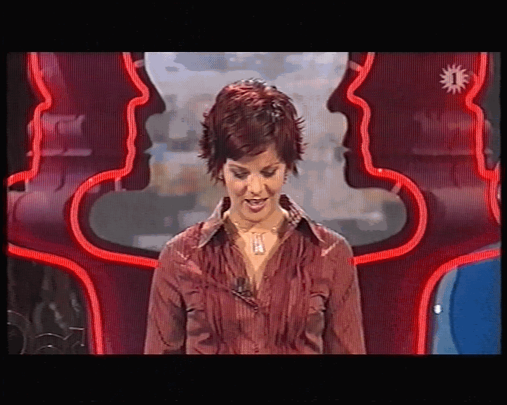

  1. I'm converting all my old VHS tapes to digital files, but I'm encountering some problems which I believe to be "dot crawl".
    Here's a little clip (the GIF has been optimized by Imgur, but you clearly see the vertical stripes moving):
    Is that dot crawl, or something else entirely?
    I've used several avisynth plugins to try to get rid of it:
    Checkmate, DeDot, DeCrawl, GuavaComb, Tcomb, ... None of them did anything.
    I'm actually capturing these tapes over an S-video cable, albeit an S-video cable plugged into a scart adapter.
    The original S-video out on my VCR doesn't seem to work anymore.

    Not dot crawl. I blame the SCART adapter, though the last time this came up the poster disputed that as the source of the problem. Try a composite capture instead.

  6. Thanks for the responses so far!
    I've tried DeStripe and Defreq, but so far their results aren't that great.
    The resize trick actually got rid of nearly everything, although there still is some kind of shimmering effect.
    I'll try capturing using the regular composite cable again, and see if that makes any difference.
    I'll also see if I can disable any VCR enhancements, I'll have to find that remote control first though
    I'm using a Samsung "S-VHS quasy playback" VCR, by the way.
    Haven't seen that pop-up on any "good vcrs to use", but it's the only one I have.
  7. Originally Posted by skerit View Post
    That's your problem -- poor luma chroma separation. You'll probably get better results with composite because the capture device's comb filter will kick in. But you'll probably still have some dot crawl artifacts at colored edges and/or moving areas.
  8. Did you try my convolution filter? I think it will do better than DeStripe and DeFreq, although I don't know about the resize trick.
  9. I did try that, but it also didn't have any noticeable effect.
    I've also disabled "IPC" on the VCR itself, but that didn't change anything.
    I tried using the dedicated composite output on the VCR, but the same problem still occurs.
    Even on the default blue menu screen, when no tape is playing.

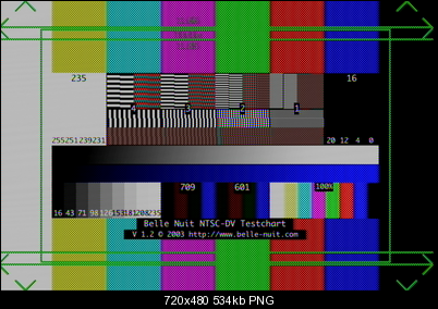

  12. By the way, for those doubting this is dot crawl: here an NTSC composite capture with a composite signal running to both the luma and chroma input if an s-video capture device, (ie, no separation of chroma from the luma, the cause of dot crawl artifacts):
    The pattern is a little different with PAL.

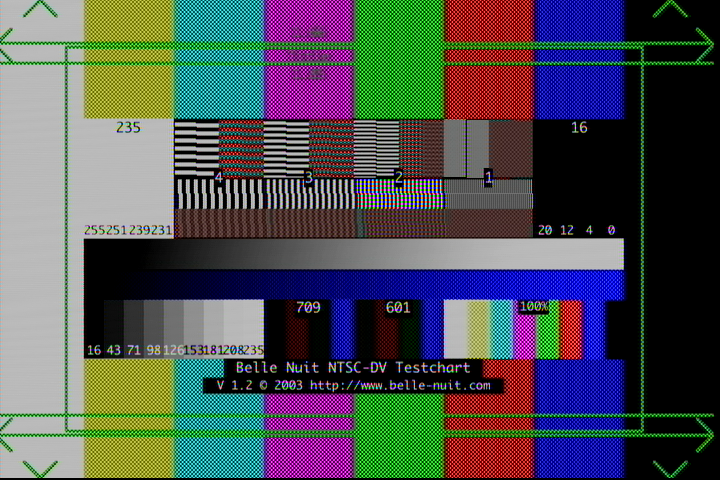

    So I've done some experimenting with this, and I have to say it seems to be the only true effective way to get rid of that vertical junk that's baked into the film due to bad transfers. HOWEVER - there is a small hiccup that I wish to address. It removes an incredible amount of fine detail in the image. See my before image of the bridge - notice the vertical lines drawn on the buildings for detail. See my after filtration, where they're blurred out.
    But again, I DO want to go with this strategy - is there any way to avoid this and still get what I want?
Name:	before script.png
Name:	after script.png
  18. You can try downscaling less. Say, to a width of 400 or 480 rather than 360. But you'll get slightly less effective cleaning along with the lesser blurring. If you're running some other temporal noise reduction you can run it while the video is downsized to help eliminate the residual dot crawl. You can also use a mask to apply the dot crawl removal to only areas of high saturation, or only near edges, whatever -- depending on the nature of the residual dot crawl in the capture.
