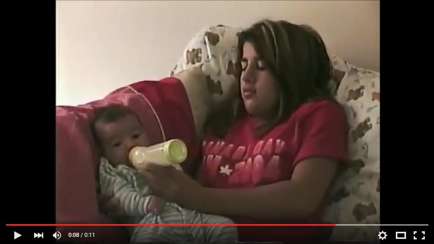

    First Capture: https://www.youtube.com/watch?v=rAZVCHSII40 (Screenshot: https://forum.videohelp.com/images/imgfiles/lIb2RPrh.jpg)
    Second Capture: https://www.youtube.com/watch?v=M8EfgXmu1us (Screenshot: http://imgur.com/027SOkB)
    Third Capture: https://www.youtube.com/watch?v=1EnFNRXyl88 (Screenshot: http://imgur.com/NvZ5tNx)
    I guess I'm just too used to 720p and 1080p...
    Editing with Windows Movie Maker and uploading to YouTube changes the quality. Actually makes it better... but you can see the difference in the screenshots (before uploading).

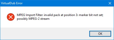

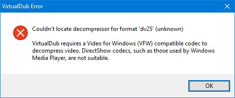

    Oh yea! And these are the errors I get when I try to open the first two files in VirtualDub...

    As for your VirtualDub error, you need to install a VfW codec. Try Cedocida and see if that works.
