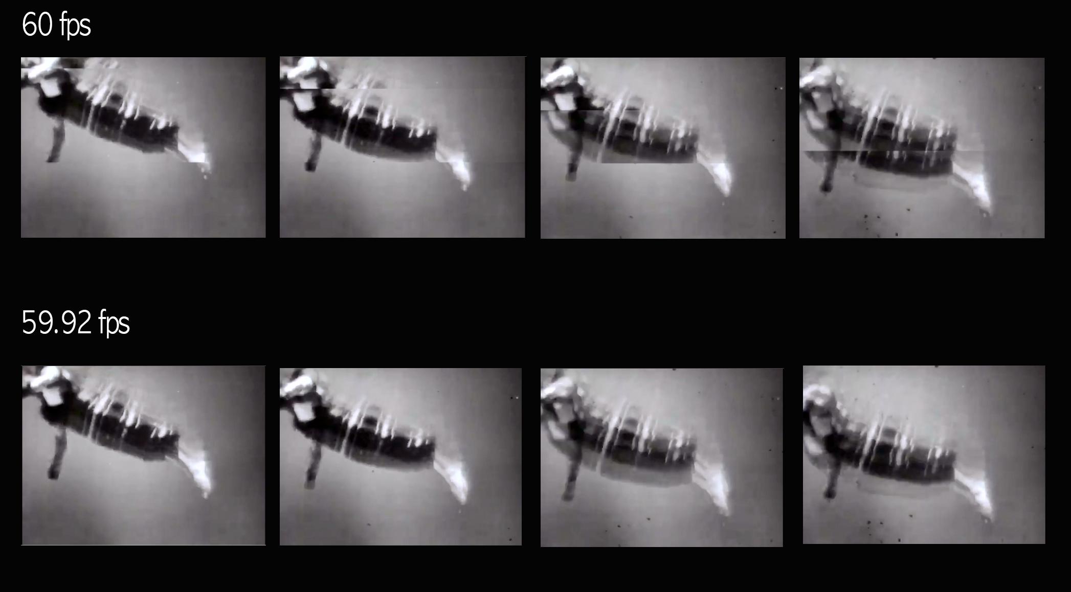

If you work around with the footage and adjust the frame rates, the "fresh" or split is coming in at different areas of the frame, depending on the frame rate, so it is not hard coded into the frame. Depending on the frame rate, all of the frames can be distorted, or only one or two within a 5-10 second sequence.
See this example:
https://forum.videohelp.com/images/imgfiles/DAy5cBr.jpg
They are the same exact frames, but interpreted at different frame rates. A "correct" frame is not displayed in between the distorted ones and the magic frame rate to make the frames line up varies constantly, changing about every 5-10 seconds. You can see in the 60fps frames that they are missing a lot of information, like the previous frames aren't being refreshed quick enough for the new frames to come in.

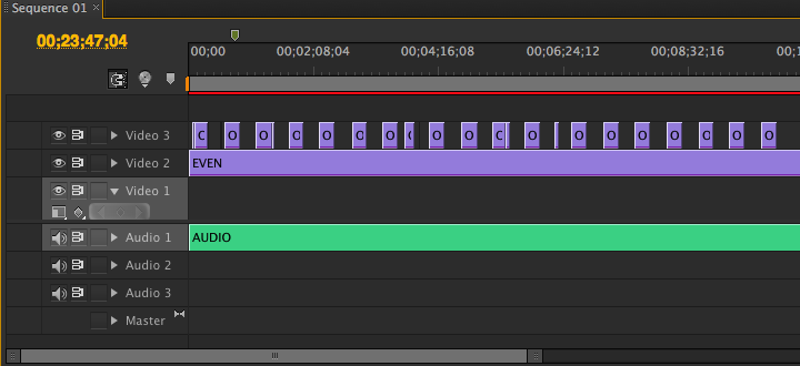

Just wanted to post my solution in case anyone comes across this in the future.
What ultimately worked for me was this.
Export individual PNG files using ffmpeg:
Since the video is 60 fps, I then used terminal to separate the even files from the odd files.ffmpeg -i video.mov -vsync 1 %d.jpg
(if you have too many frames, you will get an "Arguments too long error." Either look into how to work around this or copy/paste the files into a separate folder 11,000 or so at a time)mv /inputdirectory/*[02468].PNG /outputdirectory/
Rename the files in both folders to be sequentially numbered using NameChanger (https://mrrsoftware.com/namechanger/)
This will take two passes. First to add the sequence numbers and remove the original file name, and again to append .PNG to every file
Now you should have two video tracks stored as frames in two separate folders. One folder containing all of the even frames, the other containing all of the odd frames. At this point, they should all be numbered sequentially. So folder 1 should have the same number of frames as the second (or off by 1) and they should be numbered 001.png, 002, png, and so on.
Import these into Premiere as an image sequence (Import, navigate to your image folder, select the first one and make sure "image sequence" is checked)
Now you have an even track and an odd track. Lay them on top of each other and cut around the distortion. Using this method, it looks like the video became distorted every 30 seconds, so if I cut that part from the top video track, the underlying "opposite" track contains the good frames.
In the end, this is what my timeline looks like and the file plays in time, at the correct frame rate, with no distortion.
I still don't understand why the distortion jumps between tracks at 30 second intervals, but as I guessed, the complete frame data was there, it just needed to be sequenced properly.
Here is a sample of the repaired footage: https://www.dropbox.com/s/e0wkql8sjt5f21n/framerestore.mp4?dl=0Last edited by bmick23; 2nd Mar 2016 at 07:59.
