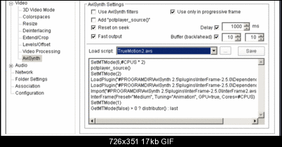

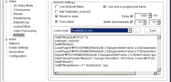

    Another option is Potplayer, and possibly a better option, as it doesn't need to install extra DirectShow filters. I haven't used it much myself but Potplayer comes configured with scripts for frame interpolation on playback. You might just need to modify the scripts according to where you've put the Interframe plugins.
    Some of the scripts use the original version of Interframe (which I think requires MVTools2), some use Interframe2, and some don't require Interframe at all. I assume they just require MVTools2. I also assume they'd be faster but lower quality.
    Of course you've got to have a fast enough PC, and it's all personal preference, but I thought I'd mention it in case you weren't aware it could be done.
