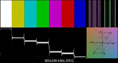

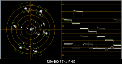

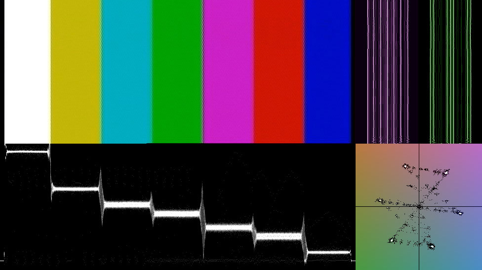

    I just got a StarTech SVID2USB2 and tried it out with a VHS tape of SMPTE bars. Here's how the bars scope in a DV capture from my Canopus ADVC110:

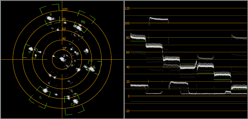

    Pretty close to hitting the marks. And here is the same tape in an uncompressed YUY2 capture from the SVID2USB2:
    The chroma is kind of miserable. Could I be doing something wrong in VirtualDub? Should I suspect a bad dongle?

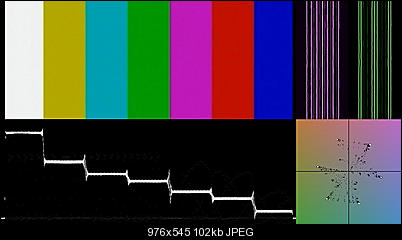

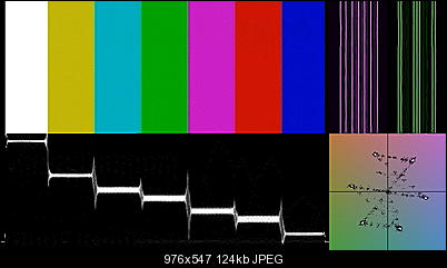

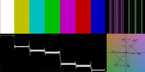

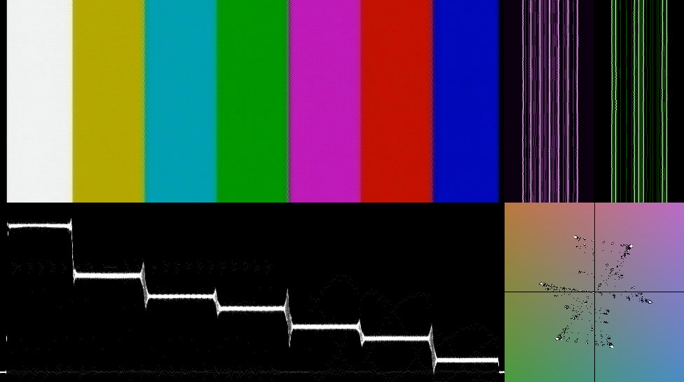

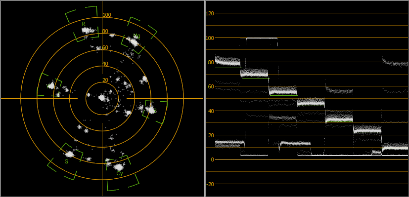

    I opened the raw files as captured and using the Avisynth VideoScope plugin, got the following results:
    DV Capture
    EZCap Capture
    The EZ file is closer in levels to the original than the DV file - I have yet to check out why that is ...
    I don't think the EzCap file is as good as the DV file, but I have to say that in general use the EZCap performs better than I expected, using the HQX codec.

  3. I think it's a rec.601 vs rec.709 problem. Try:
    ColorMatrix(mode="rec.601->rec.709")
    Some saturation adjustments may be needed before or after the colormatrix conversion.
    Maybe a YIQ vs YUV issue? Try this:
    Tweak(hue=33)
    ColorYUV(cont_u=50)
    Tweak(hue=-33)
  4. Thanks for those suggestions Jagabo. By adding the lines :
    ConvertToYUY2
    Levels(16, 1, 235, 0, 255, coring=false)
    to the DV file script, the DV file levels are now pretty much an exact copy of the original. Thanks for that.
    Am I right in thinking that The EZCap levels will depend more on the Vdub capture proc amp settings?.......
    I'm not quite sure how best to adjust them....At present they're set at the default values, with the exception of the Brightness which is set to 122.
    That was the value which seemed to be the minimum value for the white to remain at 255, as per the EBU colorbars.
    I'm also not sure if my being in PAL land makes any difference to how to approach any corrections?
    (We seem to have generally avoided having to use 'hue' over the years! )
    But the other EZcap levels are not as accurate as the DV levels, which are now nearly perfect, following your rec.601->rec.709 suggestion.

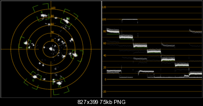

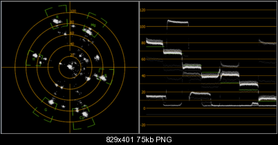

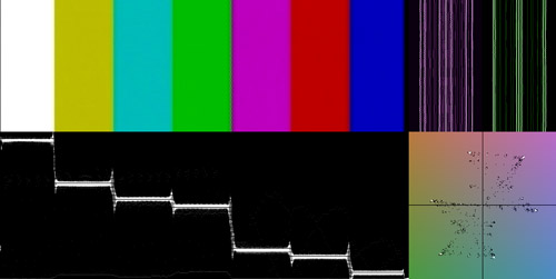

    Sorry, I didn't realize that. Okay, using ColorMatrix 601->709 on the YUY2 file gives a much better result. But why? This is an SD converter. Shouldn't it be doing the job in Rec. 601 space?
    Well my problem was that as well...

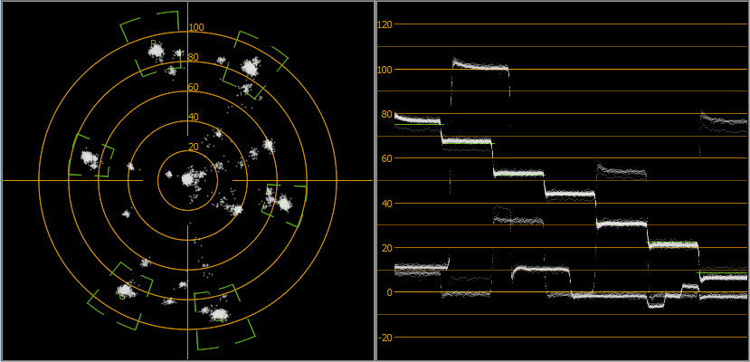

    Adding the colormatrix code to the script give much better color results:
    DV (Canopus ADVC)
    EZCap (Empia 2860 device)
    Thanks for your help Jagabo...

  11. Originally Posted by JVRaines View Post
    It makes no sense. A driver or firmware problem? And increasing the saturation a bit will get it nearly perfect.
    Using the two images in your first post, assuming the JPG images were made with a rec.601 matrix, I found this makes the DV cap match the other very closely:
    ColorYUV(gain_y=20, cont_u=13, cont_v=15, off_v=-1, opt="coring")
    Of course, the other isn't very close to correct. Adding the colormatrix adjustment makes them both closer the standard.

    Are you sure the program generating the scopes interprets SD YUY2 correctly?
    As for pippas' results, HD colorbars played on a WD TV Live to composite...
  13. Originally Posted by vaporeon800 View Post
    That seems the most likely explanation. Try using VideoScope() in AviSynth. Here's a reference using ColorBars() and VideoScope():
    ColorBars(pixel_type="YUY2").Crop(0,0,-0,240)
    #AddGrain(var=1.0, uvar=1.0) use this to make the dots more visible
    VideoScope("both", true, "U", "V", "UV")
    ovr=ImageSource("vectorscope overlay.png") # SD rec.601 color bars
    Overlay(last, ovr, x=width-256, y=height-256, mask=ovr)
    Remove the last two lines if you don't want the overlay that marks the standard locations on the vector scope. "vectorscope overlay.png" attached.

    Aug 2010
    San Francisco, California
    Ah, that's precisely it. It seems my Windows system assumes that an uncompressed AVI is BT.709. When I save in the Lagarith codec, the file is properly interpreted as BT.601.
    Now my problem is the audio hardware in the SVID2USB2. The input is too sensitive and easily clips on typical -10 dBV levels. I have to run the audio through a mixer to bring it under clipping.

    They're the scopes built into Sony Vegas. They mimic the vectorscope and waveform monitors used for decades by video engineers. I recorded tone and bars to SVHS tape with a Canopus ADVC110 bidirectional converter.

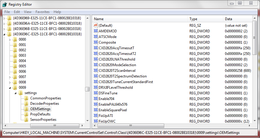

  22. Formerly 'vaporeon800' Brad's Avatar
    Apr 2001
    Vancouver, Canada
Name:	Regedit - OEMSettings example.PNG
    1. Start menu -> Run -> Type regedit.
    2. Navigate to HKEY_LOCAL_MACHINE\SYSTEM\CurrentControlSet\Contro l\Class\{4D36E96C-E325-11CE-BFC1-08002BE10318}. There are a bunch of keys under Class with similar-looking strings of characters. The first block of the one that you want ends in "C". To double-check you're at the right spot, click on this key (it looks like a folder) and you should see the (Default) value as Sound, video and game controllers in the right-hand pane.
    3. Under this key are a bunch of numbered subkeys. Expand any that have their own subkeys. You're looking for one that contains settings\OEMSettings. Hopefully you only have one of these entries, as narrowing down individual device installations is a bit more complicated.
    4. Having located the correct device and navigated to OEMSettings, right-click on the right-hand pane and choose New -> DWORD (32-bit) Value.
    5. Name it AC97VolumeLN.
    6. Double-click it and experiment with different numbers. JVRaines said he set it to 32, but I don't know whether that was hexadecimal or decimal.

    [Attachment 37777 - Click to enlarge]
    worked like a charm. I set it to 127 hexagonal and it dropped my extra loud tape into the normal range. 50 seems to be the sweet spot for my home movies, though they were not clipping to begin with, it moves their peaks to between -10 and -6. Thanks a lot, I needed this!
