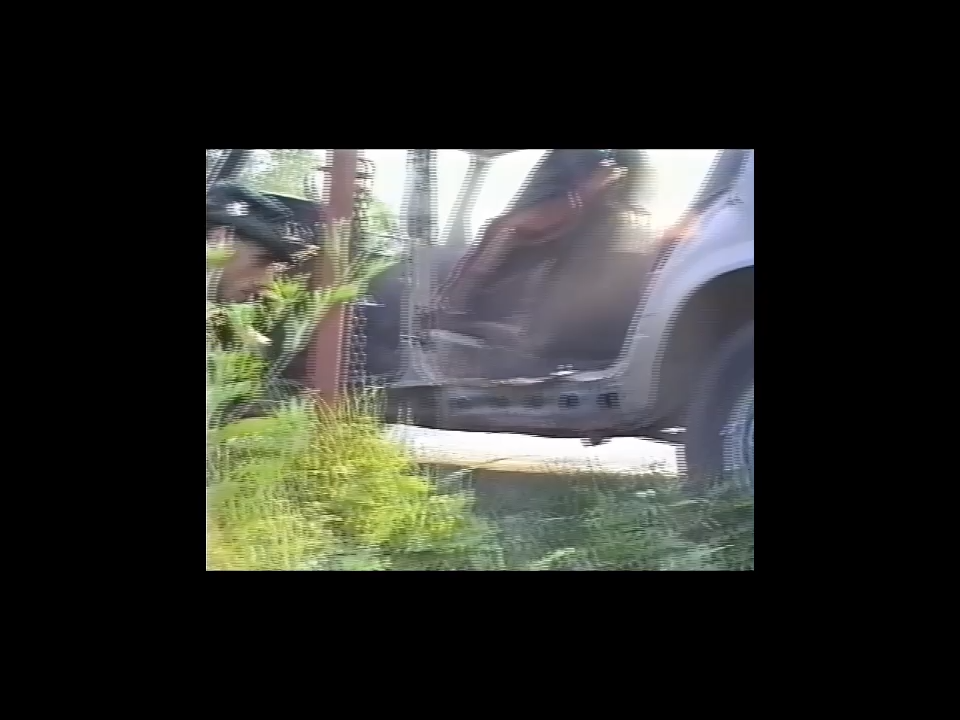

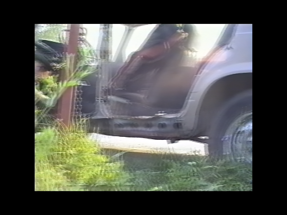

    Hi guys, I have used Movie Maker to convert a Huffyuv interlaced letterboxed (black bars) 960x720 file to a progressive letterboxed MP4 960x720 but the actuall video footage inside letterbox has symetrically shrunk after the conversion! Now I have the 960x720 file with actual video footage smaller! What went wrong, what can I do?
  2. Member DB83's Avatar
    Jul 2007
    It may be easier to understand you (I do not at present) if you were to post a cap of both the original and converted clip.
    Chances are that you have used the wrong tool. Maybe the progressive has halved the height of the video (as it can). Do you really want letterboxing in the conversion ?
    Mar 2014
    PALaland
    Here, almost the same motion scene; first pic the original interlaced capture then the converted. It is obvious that Movie Maker not only halved the actual video area inside the lettebox but also didn't deinterlace it properly at all regardless of what it now says in the file info that the video is progressive. Now I'm deinterlacing the original in Vdub first, area based, and then will try again with Movie maker to see if it's going to leave it intact. Oh, btw I'm needenig the letterbox and 720p in order to later maintain 192 kbps audio inside the video on YouTube, the video originally is a VHS capture.

  4. Member DB83's Avatar
    Jul 2007
    You still talk in riddles. What does letterboxing to do with audio ? Answer = NOTHING.
    Upload a short video sample of the original - virtual dub stream copy should handle that (you might need to change the video compression tho)
    And 960*720 is an odd AR. Seems that someone took a 4:3 video in a 16:9 pillarbox and then threw that into a 720i frame.

  6. Originally Posted by kodec View Post
    You shouldn't have capped at 720 as you ruined the field structure, thus making it impossible to deinterlace. Cap at 720x480 or 576 height (depending on if NTSC or PAL), followed by deinterlacing and then upsizing to 720p.
    Oh, btw I'm needenig the letterbox in order to later maintain 192 kbps audio inside the video on YouTube,
    Maybe YouTube gives 192 kbps audio for 720p uploads, but you don't need the letterbox. You could just upload a 960x720 video without the black bars. Adding the black bars purposely just makes you look incompetent.
    And Movie Maker is probably the absolute worst program to use for what you want.
