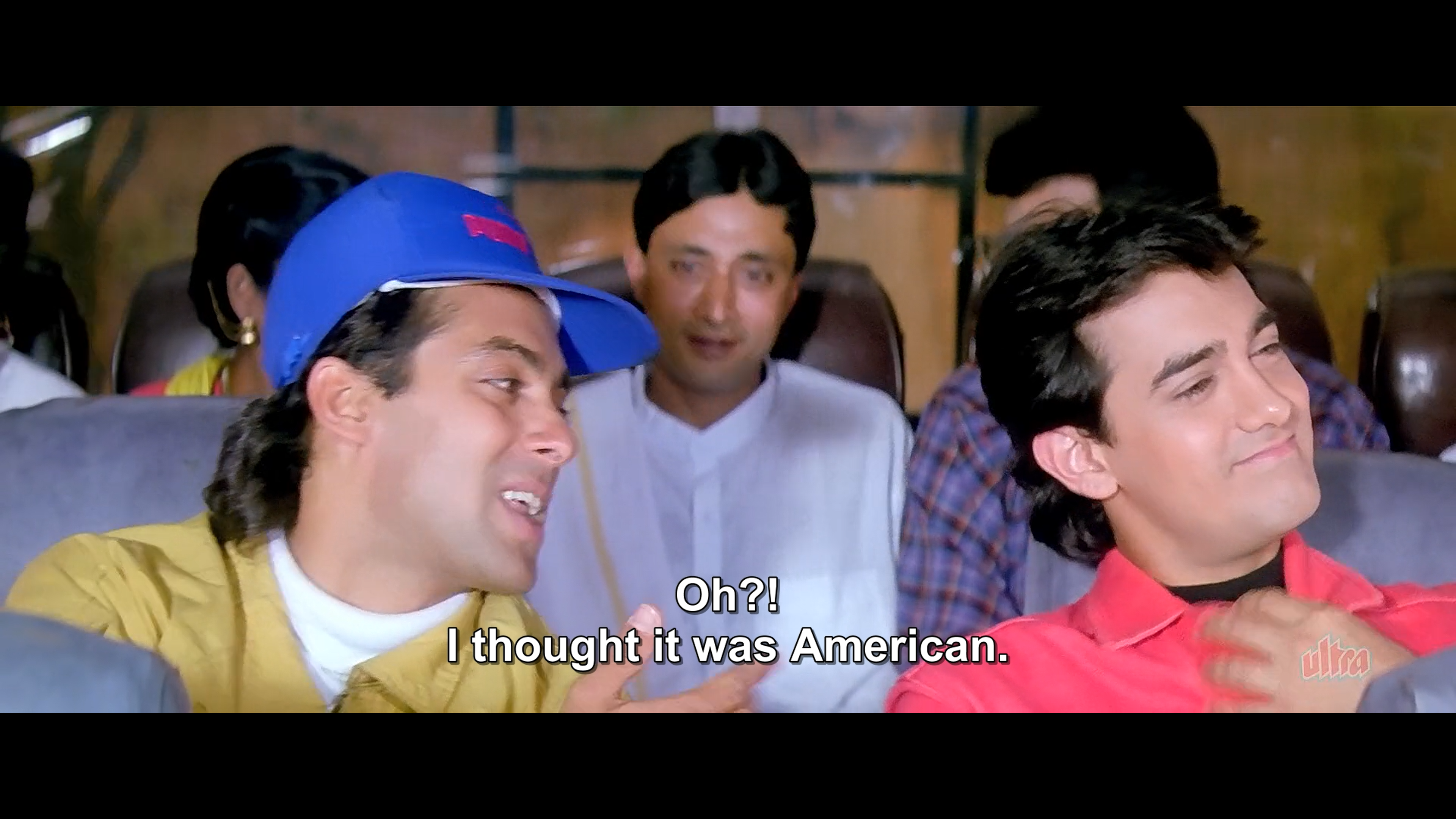

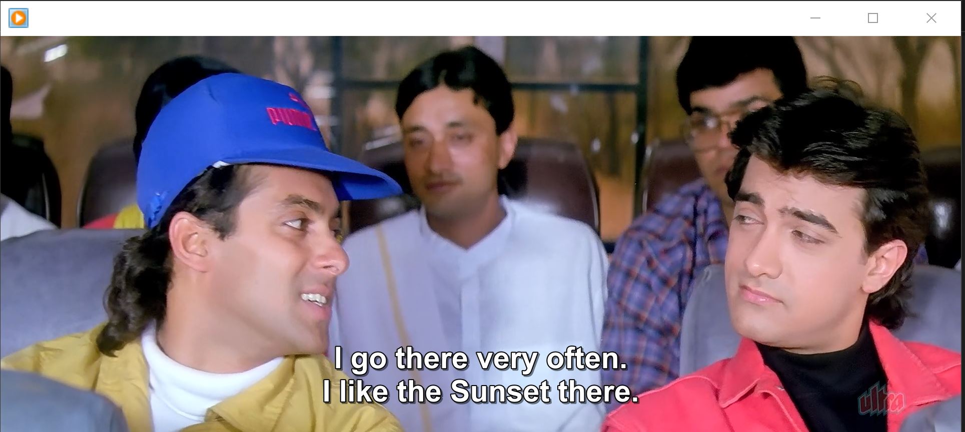

I have a similar issue on WINDOWS MEDIA PLAYER.
When not in full screen, the subs appear on the video which is fine.
But when I play it in full screen, the subs follow the resolution of the video and still appear on screen.
I want the subs to stay static (appear on the black band) despite maximizing the player screen.
[Attachment 62359 - Click to enlarge]
[Attachment 62360 - Click to enlarge]I can't live without my computer.
