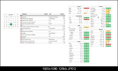

  3. You mean something like this?:
    In that image I cropped away the circles at the top of the frame but that leads to a problem. There are some parts of the video where a popup window appears in that area -- so it gets cropped away too. It will be much harder to eliminate the circles and keep the full popup window. I'd recommend you just keep the circles.

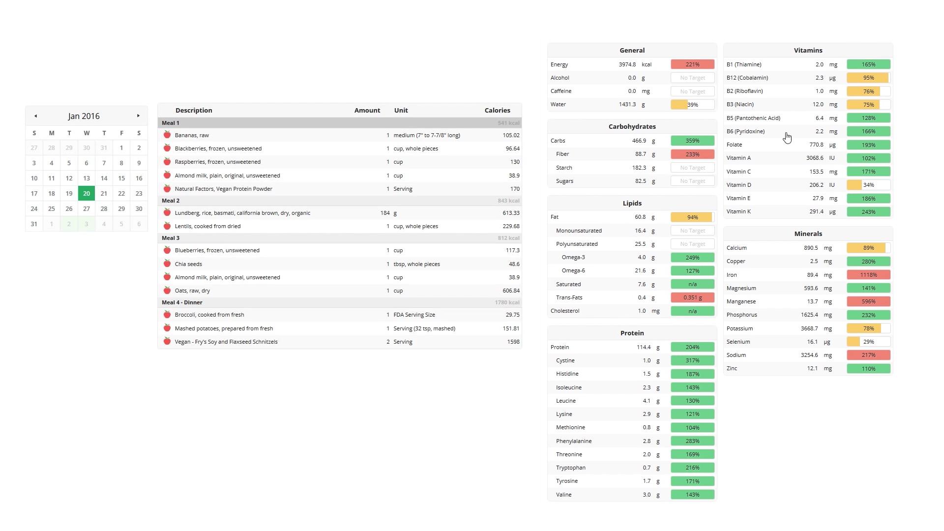

  4. Yes that is exactly what I wanted! Thanks man! Appreciate the effort. I'm in premiere I really should have mentioned that.
    I would ideally want the circles removed if this is a process that can happen. I'll be doing a video series over several months so it isn't just a once off so if I can have a template where I'll be able to just screen record and then just add it into a template that I can just put it together effortlessly if possible?

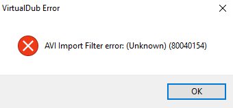

  13. 80040154, I'm pretty sure that error code means AviSynth isn't installed. Did you install 32 bit AvISynth and 32 bit VirtualDub.

    how complicated would it be to remove the circles?
    This works pretty well and leaves you with a 1920x1080 frame:
    ffVideoSource("Jan 20 Crono.mkv")
    right = Crop(726,70,720,-2).Trim(124,0)
    left = Crop(700,114,-0,-0).AddBorders(200,0,500,114,Color=$FFFFFF).Trim(8,8) .Loop(right.framecount,0,0)
    circles = right.Trim(125,125).Loop(right.framecount,0,0)
    circles = AbsDiff(right, circles).ColorYUV(gain_y=65000, off_y=-4000).Crop(0,0,-0,28).AddBorders(0,0,0,right.height-28,Color=$ffffff).ColorYUV(gain_y=30)
    Overlay(left, right, x=1000, y=50, mask=circles)
    function AbsDiff(clip v1, clip v2)
    	Subtract(v1, v2)
    	Overlay(ColorYUV(off_y=-126), Invert().ColorYUV(off_y=-130), mode="add")
