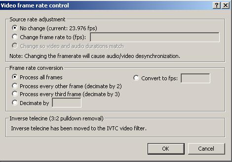

    You go into the Video section in VDub and set Video for 'Direct stream copy', and then hit 'Frame Rate', followed by changing it to whatever you like in the new screen. Then go File->Save as AVI. Changing from 30fps to 29.97fps will lengthen the video by roughly 3.5 seconds per hour or roughly 5.5 seconds for your particular video. This means (very) roughly 170 new frames added doing it the way you did. If you didn't add nearly that many frames then you'd adjust the framerate to a figure greater than 29.97fps.
