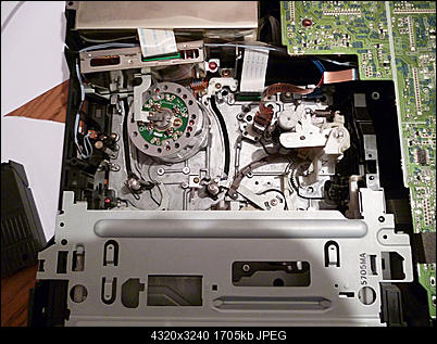

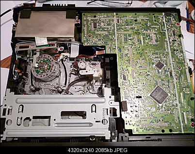

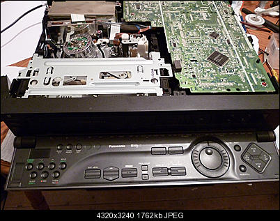

    So I had a look at this unit today. When you first plug it in the head drum spins up to a huge velocity, and carries on for about 15 seconds. It then goes into standby mode displaying error E9. Then if I press the power on button it spins up again for about 5 seconds then stops then a couple of short bursts. then it goes normal operation plays a tape, and everything operates normally. I had a look at the service manual and it says, serial clock transmission error. Any ideas?Click image for larger version

  7. In your original post, I wasn't 100% sure whether you first ran the unit before opening it up. There are several sensors in many VCRs that measure light, and they are fooled by the lights around your workbench. Someone who works on these all the time knows what sensors to cover to stop these "malfunctions," but you'd have to be familiar with each unit. So, does this problem happen when you put the cover back on?
    Also, if the unit eventually operates, maybe you should just live with the quirk and use the VCR.

    I stripped it down today re-greased, cleaned the mode switch checked all connections checked the sensors they all are giving an reading. Put it all back together, still does it. Also had a look at the power supply there where some dry points fixed them, still does it. But i did notice a bulged capacitor esr was 3 should be about 0.1 started to wonder about the rest of the caps in there. Maybe this is the problem it's not supplying the right voltage to the controller of the head drum when it is first turned on but as soon as it warms up it goes fine again. Do you think this could be the cause? I am thinking about recapping the power supply to see if this fixes the problem. Possible?

    England
