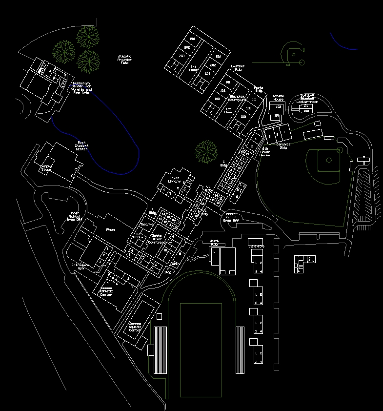

    Ouch ... reminds me of the campus in canberra ... what a nightmare that was but I lived, lol, talk about a mess with no upgrade path.
    You need a plan first not generalities as we have no idea of the mapping involved.
    1: A topographical view of campus (from above) showing the layout
    2: A popup box linked to each building indicating the number of outputs involved
    3: Location of production room
    These are end points
    4: Location of "Head-End"
    Add the want and delivery of 1080p via ip
    Using these to calculate bandwidth required should provide an answer to solving the problem

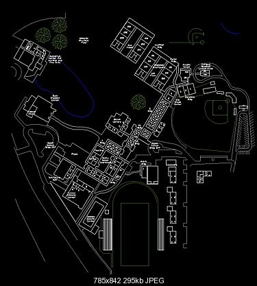

    1) Could not create the Popup boxes as you suggested, but the drawing does show the number of classrooms per building.
    2) the Production Room is in the Munnerlyn Building.
    3) the Head-End is in the Bryan Library building
    I do need to add that we currently have Fiber to ALL buildings from the Bryan Library. We also have spare fiber that could be used "ONLY" for this task, or we also have the ability for it to have it's own VLAN.
