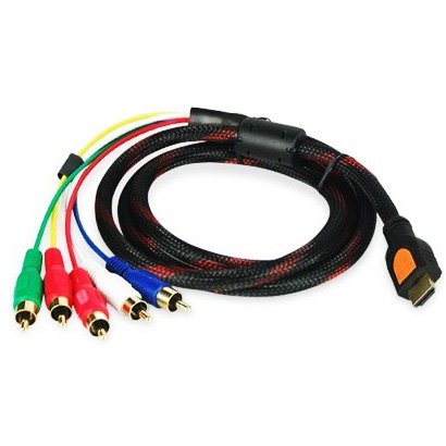

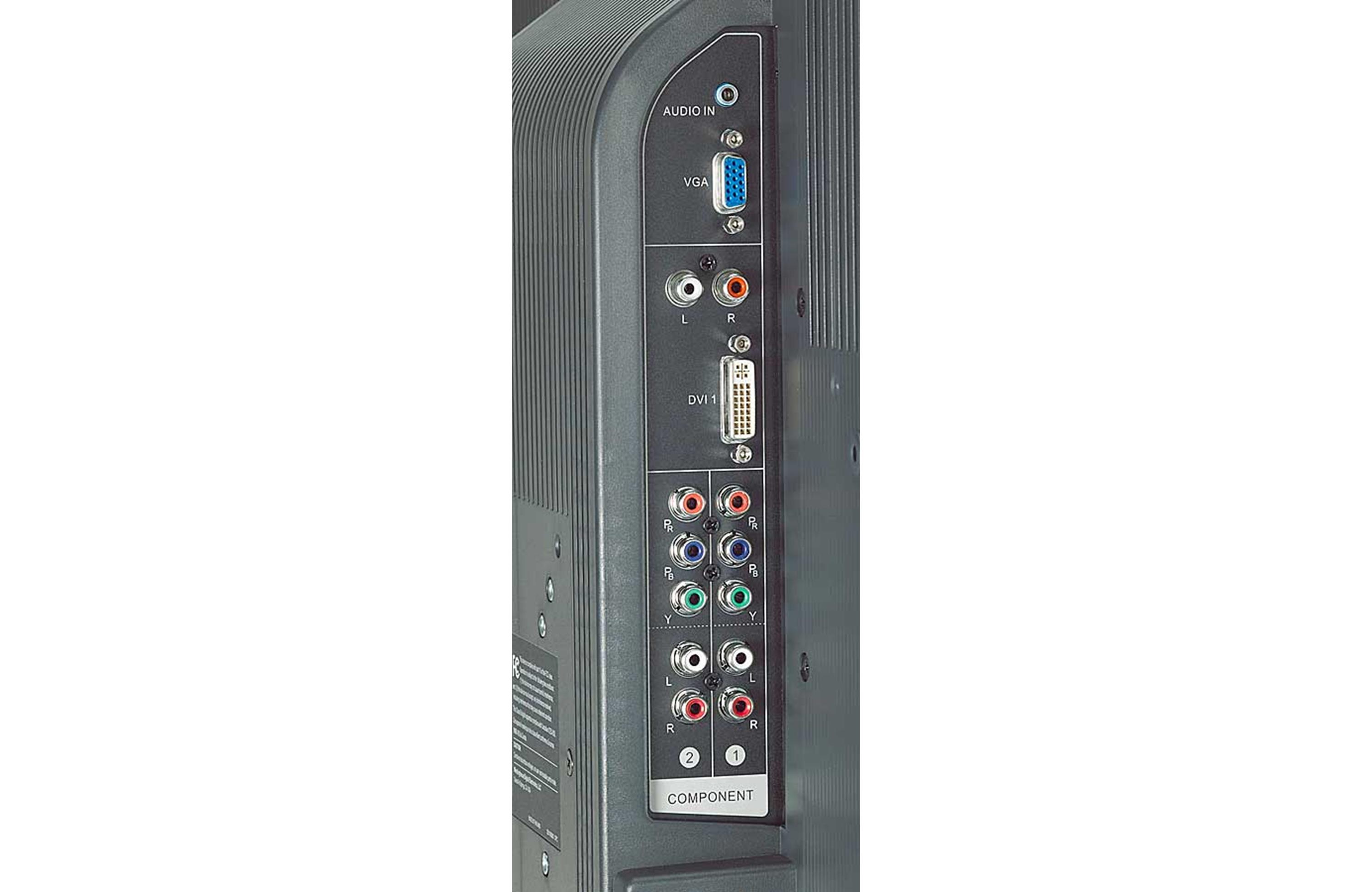

  2. The red, blue and green conectors should go the to one set of video component inputs on your tv, the additional red and white should go to the audio of the same component input. Just follow the colors (and swap the red ones if you get them wrong.)

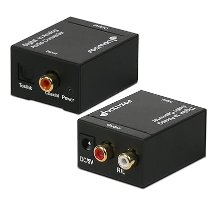

  3. Use your HDMI to DVI cable plus a coax to analog RCA audio converter like this:
    http://www.amazon.com/Portta-PETDTAP-Digital-Optical-Converter/dp/B005DIRI6I/
    and stereo RCA audio cables.

    i tried this several ways. the only cable tha might get mixed is the red video/red audio. i get no video or audio at all with this cable.
  5. Originally Posted by jagabo View Post
    the dvd player doesnt have a TOS link? i dont see it. if this works it would be a great solution. are their outputs on the other side of this box? i dont see an output i can use. sorry for my ignorance.
    oh nvm i see : http://ecx.images-amazon.com/images/I/610eK9YwEmL._SX425_.jpg
  6. thanks jagabo !! i am going to try your proposed solution.

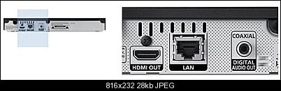

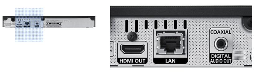

  7. The picture of the back panel in your Amazon link shows digital coax audio out.
  8. Originally Posted by jagabo View Post
    [Attachment 35746 - Click to enlarge]
    yes, sorry i was referring to the converter. the pic you posted on had tos and coax.. i am easily confused further pic i found showed connectors on the back of the converter. sorry for confusion. thanks a bunch for your inputs!

  10. Yeah, you need an "active" HDMI to Component cable/adapter to do this, basically you're converting from digital to analog hence the "active" part. The SODIAL cable won't work, it's "passive." The advice above as to other adapters will work fine, or for a "one-step" solution so you don't need a separate audio converter, look for a cable like this: http://www.mycablemart.com/store/cart.php?m=product_detail&p=5670&gclid=CL75uqK7gssCFZCIaQodhNUNbQ
