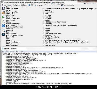

    Looks like your 'STCO' atom (Chunk Offset Atom) of the MP4 video got hosed just before the UDTA (User data) Atom got added. That's probably why the video jumps from 17:03 to about 17:45 and misses a short portion on the glitched one.
    Fixing it will be extremely hard since the structure of an MP4 is intertwined together and VERY hard to decypher:
    Atom stbl @ 155491 of size: 321786, ends @ 477277
    Atom stsd @ 155499 of size: 94, ends @ 155593
    Atom mp4a @ 155515 of size: 78, ends @ 155593
    Atom esds @ 155551 of size: 42, ends @ 155593
    Atom stts @ 155593 of size: 24, ends @ 155617
    Atom stsc @ 155617 of size: 37312, ends @ 192929
    Atom stsz @ 192929 of size: 271700, ends @ 464629
    Atom stco @ 464629 of size: 12648, ends @ 477277
    Atom udta @ 477277 of size: 516, ends @ 477793

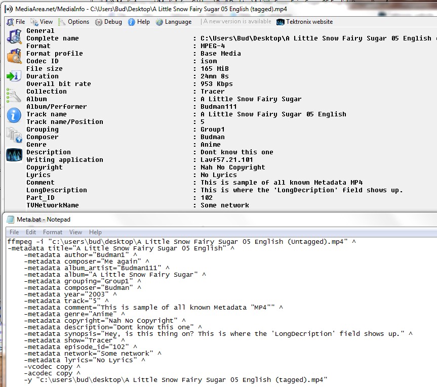

    Best way is for it not to happen by using another tagging system such as MetaX (NOT freeware) of FFmpeg. I also question updating MP4 with MP3 tagger? The Metadata is different for each. It may have worked but... Check out this page for appropriate Metadata for mp4 based containers:
    http://atomicparsley.sourceforge.net/mpeg-4files.html
    FFmpeg works okay or seems to. https://www.dropbox.com/s/u6x6zu7gvo4we2q/A%20Little%20Snow%20Fairy%20Sugar%2005%20Eng...ed%29.mp4?dl=0
