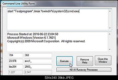

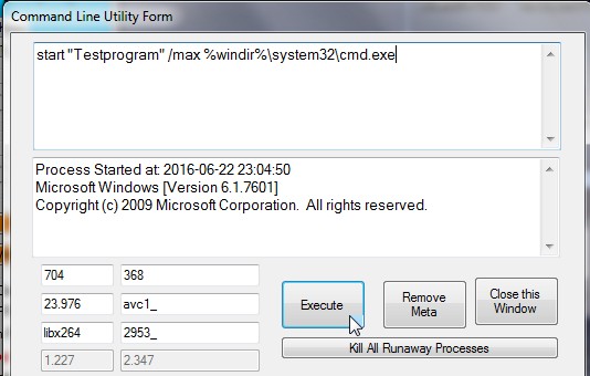

    It is fairly easy to program a test box as Pseudo CMD (DOS) window and you can update/enter/change/etc. and then execute manually or program wise. I'm not sure if this would work but it would be better in most cases than a CMD script, especially for updating before execution efforts.
Name:	ScreenHunter_197 Jun. 22 23.06.jpg
