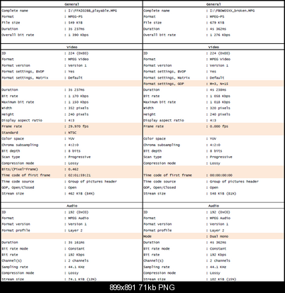

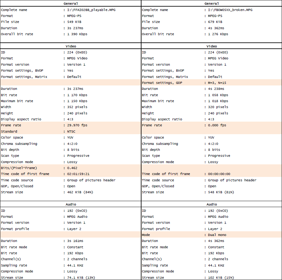

  6. Well, I do have the game CD, but unfortunately none of the hardware to actually run it; and I don't know anything about disassembly to try and figure out what it needs... It seems so close to being right, though. It doesn't really look like its scrambled.
    On another note though, your previous post (and my subsequent realization that I hadn't thoroughly looked at the metadata for each type of file) made me realize I should take a closer look. It looks like there is actually a lot of disparity between them.
    I'll have to see if I can get some more of these properties carried over to the unplayable file.
  7. Member DB83's Avatar
    Jul 2007
    Very odd. The playable one does not have a GOP structure (which it really should)
    Another possibility. Some form of copy-protection is underway so there is something else on the CD to help them play.
    The time-code is an odd one and that may hold the key.

    i played with the sequence header a bit and made it the same as the playable one.
  9. Member DB83's Avatar
    Jul 2007
    ^^ It's actually worse
  10. aBigMeanie aedipuss's Avatar
    Oct 2005
    666th portal
    plays the same here. both the broken one and the transplanted header version play with artifacts in vlc.
    Maybe I did not get passed the first few seconds but I saw much more disturbance - the lady was surrounded by pixels whereas when I played the original this morning I just saw a little interference.
    But after reading the above links there is more than meets the eye. This double-pixels may have something to do with it - 320*240 playing as 640*480 - whereas our players just play it as 320*240.
    I thought quicktime players always played mpeg but there appears to be an extra codec level here..

  19. Member DB83's Avatar
    Jul 2007
    I would be more worried if it did not play the 'playable' file 'just fine'
    Someone may be able to translate all those error messages but it is more likely that, as pdr states, modern players have little concern for legacy formats such as full mpeg1 support.
    I well remember those VCDs and if you copied the main video file to your HDD and renamed it to mpg it played but not so smoothly. Seems that something similar is happening here.
  20. Originally Posted by DB83 View Post
    Sometimes an old clip needs an old program.
    Went in to my archives and found a c2007(2002-2006) version of Media Player Classic(Unicode build) v6.4.9.0 (Gabest)
    Played the clip smoothly without a single artefact.
    Wow, thats awesome. Thanks for all your help, guys! What a great community
    But are the clips actually broken ?
    The link shows this game was issued with that card - not the card with the game (an important difference in my book). So the game is designed to show off the card.
    If they did not play with the card then, yes, they are broken. There can be no guarantees for other playback. And was this form of the game actually released on it's own ?
    There are two MPEG versions of the game, both bundled directly with an add-on decoder card. This one is for Mac. The other one is for DOS and was included with the Sigma Designs ReelMagic MPEG card.
  21. MPCHC plays both files properly using Windows' built in MPEG 1 decoder (quartz.dll). Just disable MPCHC's internal MPEG1 decoder (and any other DirectShow MPEG1 decoders you might have installed). And of course WMP plays it with that decoder too.
    I have a a bunch of old games (in their original boxes, etc.) on a shelf in my office -- the PC version of Return To Zork is among them. Unfortunately, when I opened the box there was no disc inside.
  22. DECEASED
    Jun 2009
    Heaven
    That 'broken' file does not have a frame-rate.
    For me at least, it's very difficult to believe that those flaws are not flaws at all.
    Until proven otherwise, I serious doubt the MPEG-1 specs do not require the stream headers to inform about the frame-rate and the GOP structure.
