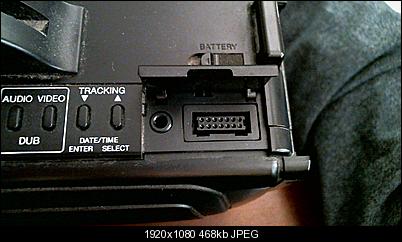

    I was going through my parent's stuff and came across an old camcorder they used in the 1990s. It seems a shame to me to throw away the lens and electronics. Does anyone know if these can be set up to make digital recordings? I know that the video quality on VHS was crummy but didn't know if that was a limitation of the camera technology or the recording media. Any insight is appreciated.

    Well if the camcorder does have an S-Video or Composite video output (it most likely has one) as well as audio you can record the signal with anything you like (say a USB-Capture device connected to a Laptop to make it portable; or a more modern MiniDV/Digital8 camcorder with analog in).
    However, do not expect pristine quality with this. It's still analog SD video from an old consumer video camera with (probably) a single CCD sensor, but it should be much better than recording to VHS indeed.

    Thanks for the reply. Unfortunately, it does not have an S-video port for the video output but it has this: Click image for larger version
Name:	Camcorder Video Out Port.jpg
    Do you know what type of port this is?
    Thanks,
    Steve
  4. Member Skiller's Avatar
    Oct 2013
    Germany
    It's a proprietary connector.
    Should be close to impossible to find a cable, but it should work if you modify/solder any ordinary Composite cable to the right 2 pins (if it's a VHS camcorder, rather than S-VHS, then there is almost certainly no S-Video output, only Composite).

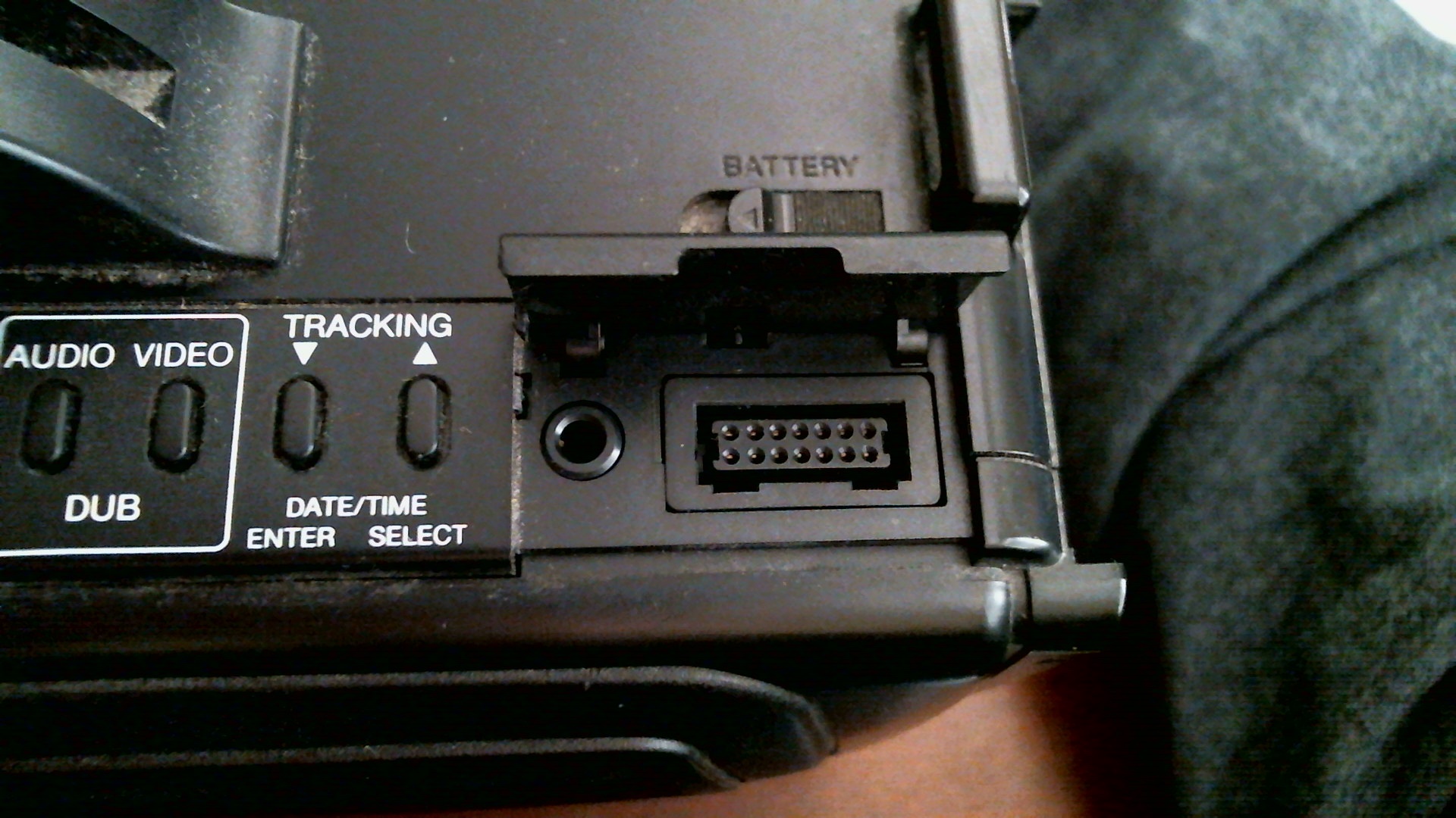

    In the photo above, the connectors are cited as "proprietary" vs. the standard red/yellow, aren't they?
