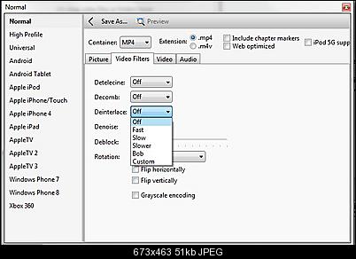

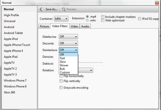

    I do not believe vidcoder or handbrake will accept Avisynth files but will take VOB files (at least Vidcoder does) and FFmpeg will take Avisynth files. The VOB files can be joined with the DOS copy binary format such as copy /b video1 + video2 Joined_Video1 format.
    BTW, I don't usually use Vidcoder but it does have Several filters including deinterlace and detelecine so you might want to check it out. I believe it is a front end for Handbrake also.
